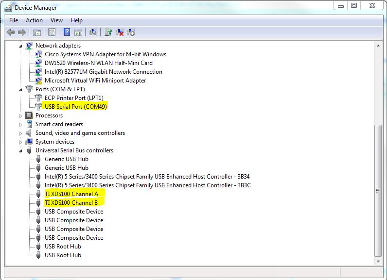

    To answer a question you asked previously, the board definitely has an xds100v1 on the board.  (I designed it)
    Based on what you've written up, the FTDI driver has now been programmed correctly and the xds100v1 worked well enough to get programmed in the first place.
    The next step is to see if Windows is happy.  In Device Manager, do you see the highlighted entries below?
    If so, I think CCS isn't playing well.  I would recommend trying the 'Test Connection' button in your target configuration (within CCS) and let us know what the output is.
    If not, I think Windows is having some kind of driver issue with xds100v1 (a hardware issue isn't completely out of the question though).  Based on previous experience, a reinstall of CCS may help this - a fresh install will reinstall the drivers.  If you want to try something before resorting to that, I have attached the drivers here:
    /cfs-file/__key/communityserver-discussions-components-files/171/XDS100-Drivers-v1.0.zip
    Let us know which bucket you fall into.  Hopefully this gets us closer to the resolution.

  • Brett,
    I guess I have good news although unfortunately I don't have a thorough understanding of what is going on. I don't have to tell you that I'm new to DSPs, this environment, and software in general. I've been designing power electronic circuits for over twenty years, but it's time that some one in my company understands this stuff so I've committed myself to the task.
    So the good news is, I've connected to the peripheral explorer board and have run a project. Specifically lab 7, which performs basic PWM exercises from the C2000 Teaching CD ROM. Anyway, in my frustration I set up the project (Lab 7) and realized that the ccxml file under targetConfigs was not what it should have been. I guess it defaulted to the file I created when I first tried to connect. I actually selected the XDS110 Debug probe for that target configuration. So I created a new target configuration file F28335XDS100V2.ccxml, selecting the XDS100v2 (I believe you that it should be version 1, I just selected version 2 because that's what we did in the class I'm taking) and it connected. I went into Debug mode and played around. It was great!!!
    However, I still have a superficial understanding of what's going on. When I'm in the editing perspective for Lab 7, in the F28335XDS100V2.ccxml tab, if I try the Test Connection button, I still get that "An error occurred while hard opening the controller" error.
    To answer your questions:
    In Device Manager, under Ports, I have USB Serial Port (COM6)
    Under Universal Serial Bus controllers I have:
    TI XDS100 Channel A
    TI XDS100 Channel B
