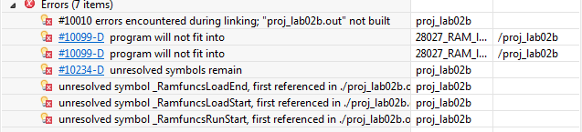

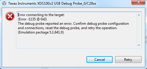

I have just received my C2000 Piccolo Launcpad: LaunchXL - F28027F and my Booster pack BOOSTXL-DRV8301. I have installed CCStudio, GUI Composer and MotorWare. Currently I am trying to debug one of the examples provided in MotorWare and upload it to the board before I start trying to write my own code.
The thing is that everytime I try to debug the Code I get the following error:
"C28xx: Error connecting to the target: (Error -1135 @ 0x0) The debug probe reported an error. Confirm debug probe configuration and connections, reset the debug probe, and retry the operation. (Emulation package 5.1.641.0) "
How can I resolve this? These are my project settings, which I believe to be correct.
 (Sorry if this isn't formatted correctly, my internet is really slow)
Thanks in advance,
Michiel
  • Hi Mike,
    Can you check the boot switches at S1? Are they properly set ie in ON position?
    Gautam
  • Hi Gautam,
    I can confirm that all the switches are set in the On position.
    Michiel

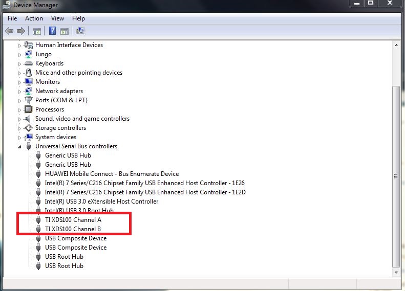

  • Did you try replacing the data-cable? Also, are the drivers installed properly? Please check your device manager, you should be able to see 2 channels A&B:
    Gautam
  • That should be in order aswell, I will check this next Tuesday since my hardware is still at the campus and I won't be there until then. Already thanks for your help!
    Kind regards,
    Michiel
  • No problem. Keep us informed.
    Gautam
  • Yes I can see both channels on my device manager!
    These errors also pop up on the problems tab, if they can be of any use to you.

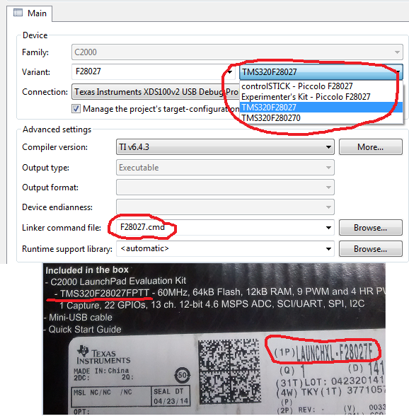

  • The .cmd file seems to be RAM based and not Flash based. Can you try with F28027.cmd that can be found here:
    C:\ti\controlSUITE\device_support\f2802x\v129\DSP2802x_common\cmd
    ie check with flash configuration
    Gautam
  • Appearantly I don't have controlsuite yet, getting it now!
  • Okay So I didn't find control Suite on my PC but I did find the F28027.cmd in the drop down menu under linker command file. I tried this without success though. Do I still need to change this somewhere else?
    The errors however have been reduced to just 2, aside from the one "Error: -1135" stated in my first post. I am still not able to connect to the debug probe.

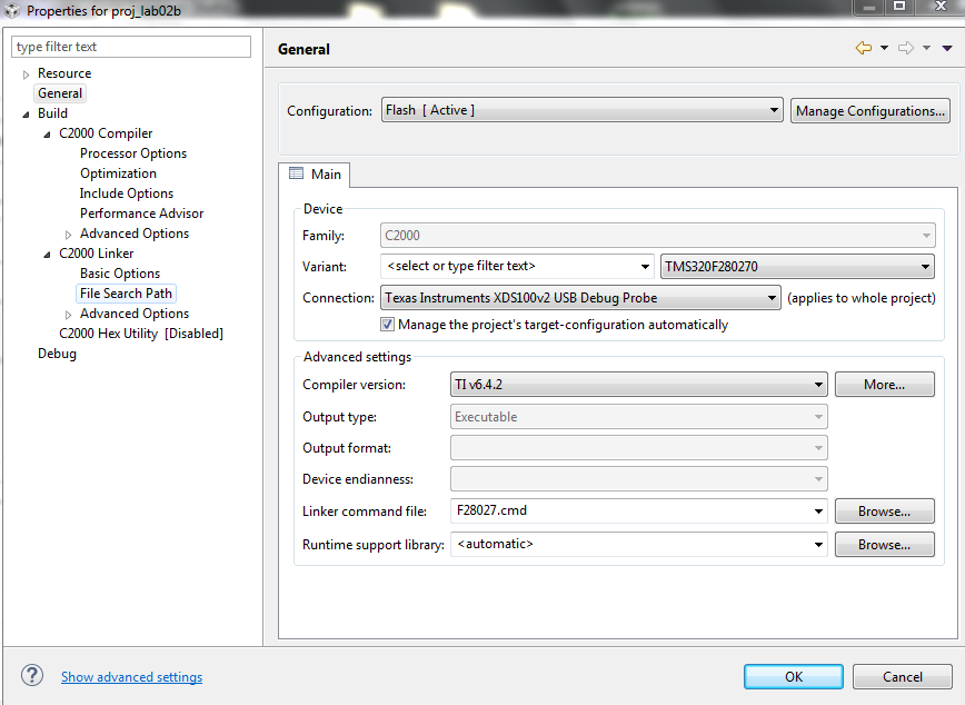

  • Okay so I did some more digging and in this: https://e2e.ti.com/support/microcontrollers/c2000/f/902/t/398617 thread I realised that there is indeed a difference between the LaunchXL - F28027 and the F28027F. I never really thought that this was the case since there was never an option in any of the menu's to select the F28027F as shown below.
    Could this be my problem? And If so, how can I get the F28027F to show up in the menu's? Or is this neglectible?
    Also included a picture of the box to make clear what exact type of board I have.
  • Hi Mike,
    F28027 device selection is correct for F28027F too. Yes, in the previous post you'd selected the wrong device which you corrected later.
    Do does it build well?
    Gautam

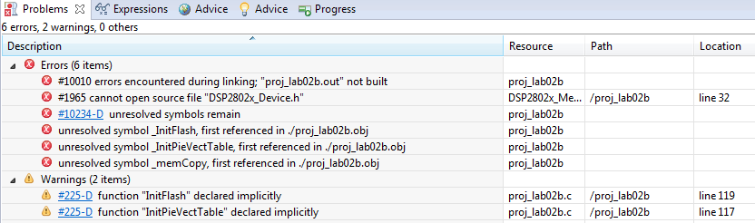

  • No, it is not building correctly. If this was the case I would have posted that. I installed controlsuite and used the Linker file you mentioned earlier. I am still getting these errors, which link through to the code above. Do you have any idea how I can get rid of this? I really need to get this sorted as fast as I can.
  • Here are the detailed steps to run the program from flash:
    You need to add these two statements
    MemCopy(&RamfuncsLoadStart, &RamfuncsLoadEnd, &RamfuncsRunStart);
    InitFlash(); after InitPieVectTable();
    Add DSP2802x_MemCopy.c file to the project.
    Define extern variables above main() function.
    extern Uint16 RamfuncsLoadStart;
    extern Uint16 RamfuncsLoadEnd;
    extern Uint16 RamfuncsRunStart;
    Replace 28027_RAM_lnk.cmd with F28027.cmd
    Compile the code.
    Configure your GPIO's to boot to flash.
    Gautam

  • Alright, but where do I need to add that code? In what file?
  • main.c (or the main c file)
    I would like you to refer this sample example: C:\ti\controlSUITE\device_support\f2802x\v129\DSP2802x_examples_ccsv4\flash_f28027
  • A part of the code you are proposing is already present in this form, should I just leave it as it is or should I replace it with your version?

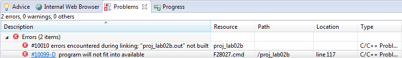

  • These are the errors I get after working out your suggestion, I left the code which was already in place (as shown above) since it seemed to me that this did the same.
    I'm sorry to keep bothering you with this. I really need to get this figured out and I don't know where else to go :/
  • I would like you to follow this example code: C:\ti\controlSUITE\device_support\f2802x\v129\DSP2802x_examples_ccsv4\flash_f28027
    Gautam

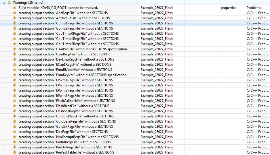

    Would you mind going over the basic setup instructions with me one last time to make sure that I didn't do anything wrong or misunderstood anything from the included guides / pdf's? Because they can be a bit vague from time to time.
  • Sure, why not!
    Launchpad's S1 & S4 -> ON Position
    Import this project:
    Target configuration -> XDS100v2 and TMS320F28027
    Build and then try Debugging. Let me know what you observe.
    Gautam
  • When assigning the target configuration I get these warnings.
    After building I got all these warnings, no idea where they came from.
    And after debugging I got this error, which has been my problem all along.
    The switches are configured correctly, the launchpad is on an is showing in the device manager. I just don't get it.
  • I hope you've CCS v6+ right? Also, which folder is your CCS and controlSuite are installed?
    Generally it should be: C:\ti\ccsv6  &  C:\ti\controlSUITE
    There seems to be a lot of linking issues. Can you try replacing this cmd file to your project: F28027.zip
    Gautam
  • Yes I am using CCS V 6.1. They are installed in said folders.
    Tried using that cmd file already, no success. Also tried with the other one you linked, no more warnings but still getting the same error I've always had "Error connecting to the target etc.."
