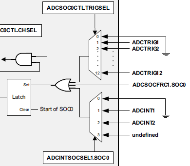

problem of using the ADCINT1 to trigger the ADC SOCx
I am learning the piccolo series DSC with F28069 and have tried different ways to trigger the ADC SOCx.
Firstly, I used the timer1 as the trigger and it worked well.
Then I want to use the ADCINT1 as the trigger to make a continuous stream of conversions.
In the guide it says the setting of ADCINTSOCSEL1 will override the TRIGSEL field in the ADCSOCxCTL register, so I just add some code to my previous project as shown below.

	AdcRegs.ADCINTSOCSEL1.bit.SOC0 = 1;    //ADCINT1 will trigger SOCx. TRIGSEL field is ignored

At first I thought the ADC will not work for the ADCINT1  trigger could not occur and I should force the EOC7 to start by ADCSOCFRC1 register.
However I ran the project and the ADC ISR counter increased.
Then I tried to stop the timer1  by commenting out the
//CpuTimer1Regs.TCR.bit.TSS = 0;    //start the timer1
and the ADC ISR counter remained as zero.
So is there something wrong with my configuration ? I don't know how the timer1 triggered the ADC SOC.
