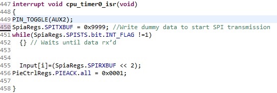

3. Is there any way I can fix data reception and transmission rate(not baud rate of data)? I tried to program SPI(not using SPI interrupt) in internal interrupt generated by CPUTimer0 of which time interval is fixed, but it doesn't work. The problem now is that in the CPUTimer0ISR, SPIINT.FLAG which indicate the completion of data reception will never set high, and the program will get stuck in the while loop iteration like shown below. Is it feasible for me to do so? Can I realize it using SPI interrupt?

    1. In my application, SPI is used to drive "chip selection"  end of an ADC chip and store received data in SPIRXBUF. I need to receive one data transmitted from SPI and do some computation, so SPI transmission is not consistent. Also, I need to remain an fixed sampling frequency, so I decided to use interrupt to trigger my SPI transmission. This interrupt is triggered by CPUTimer0 and is shown below. My main function is just an infinite for loop waiting for this interrupt.
    When viewing SPI transmission result, I found the value of (SpiaRegs.SPIRXBUF<<2) was always 0, which means the subroutine didn't even complete and jump back to main function. On the contrary, using SPI transmission with program of line 450 to 455 in main function directly would give me  correct value. It seems to be trapped in the while loop if used in interrupt subroutine. Does anyone know how was this happened?

    To answer questions 1 and 2, the FIFO interrupts are meant to occur when the FIFOs are at a specific level of fullness. They tell you about the FIFO status. They do not cause the SPI operation to halt or anything like that. For example, say you want to get a SPIRXINT when at least two words have been received and are in the FIFO. You would set SPIFFRX.RXFFIL equal to 2 in your configuration code. So when two words have been received and have yet to be read out of SPIRXBUF, the SPIFFRX.RXFFST field will be equal to 2 and an interrupt will occur.
    To answer number 3, I don't know what you're sending and receiving data from, but I'm not seeing any issues with initiating the transmission by writing to SPITXBUF in the timer ISR. However, instead of a while loop in the timer ISR, using an SPI interrupt to let you know that  you received data should be feasible.  Then you can read the data from SPIRXBUF in the SPIRXINT ISR. Since you'll be using the timer ISR to initiate the transfer, I don't think you need to bother with the SPITXINT interrupt.
    It might be helpful for you to do a quick exercise where you take Example_2833xSpi_FFDLB_int and modify it to send data from a timer ISR instead of the SPI transmit ISR. Once you've got it working in that loopback example, maybe it will be clearer on how to do it in your project.

  • Hi Whitney,
    I've already solved this problem, and my code is incorrect for trying to call SPI transmission function in the internal CPUTimer interrupt. So I use SPI interrupt and remove this part out of CPUTimer interrupt, and it's working perfectly fine.
