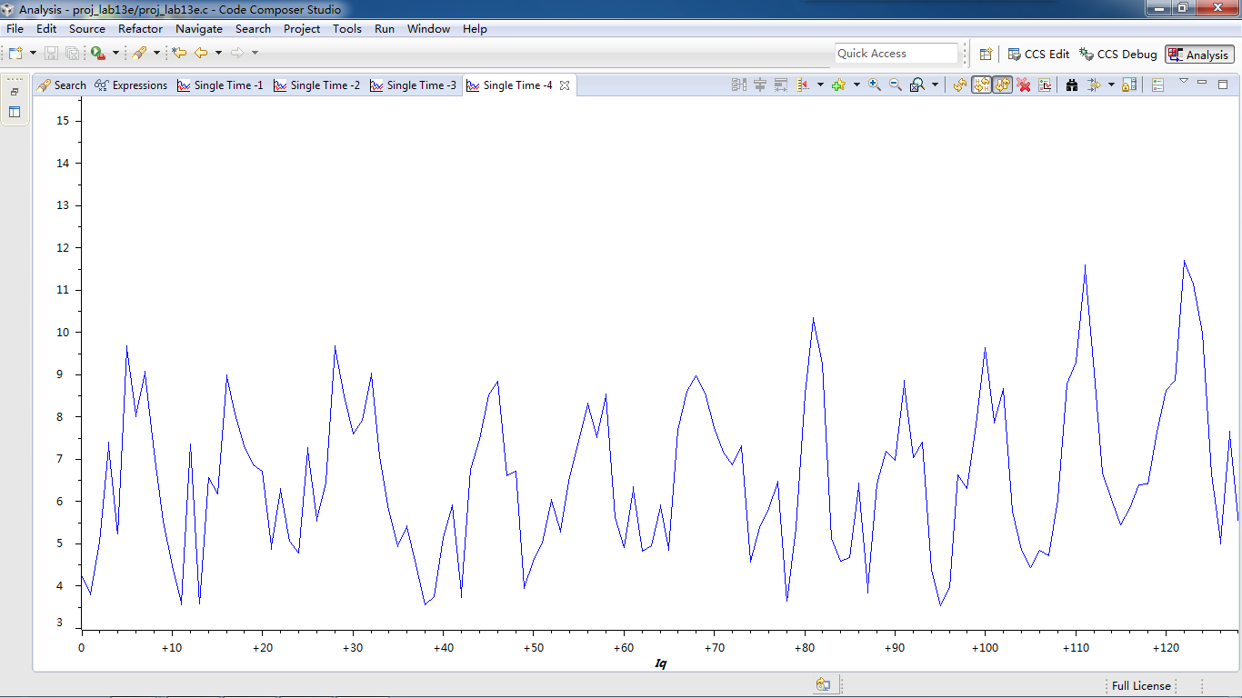

First, we apply a certain load on the motor shaft. Then we start the motor and increase the speed. With speed increasing, the IqRef increase little by little. But when the speed reach a certain value which is less than the max speed, the IqRef suddenly gets to USER_MOTOR_MAX_CURRENT. The motor begin to stop and move, stop and move. The load we apply to the shaft is small, and when this saturation happen, the motor output power is far less than the rated power of the motor.

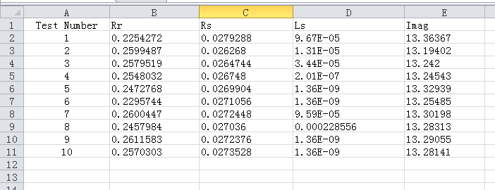

Here are our user.h and motor parameters in German.
