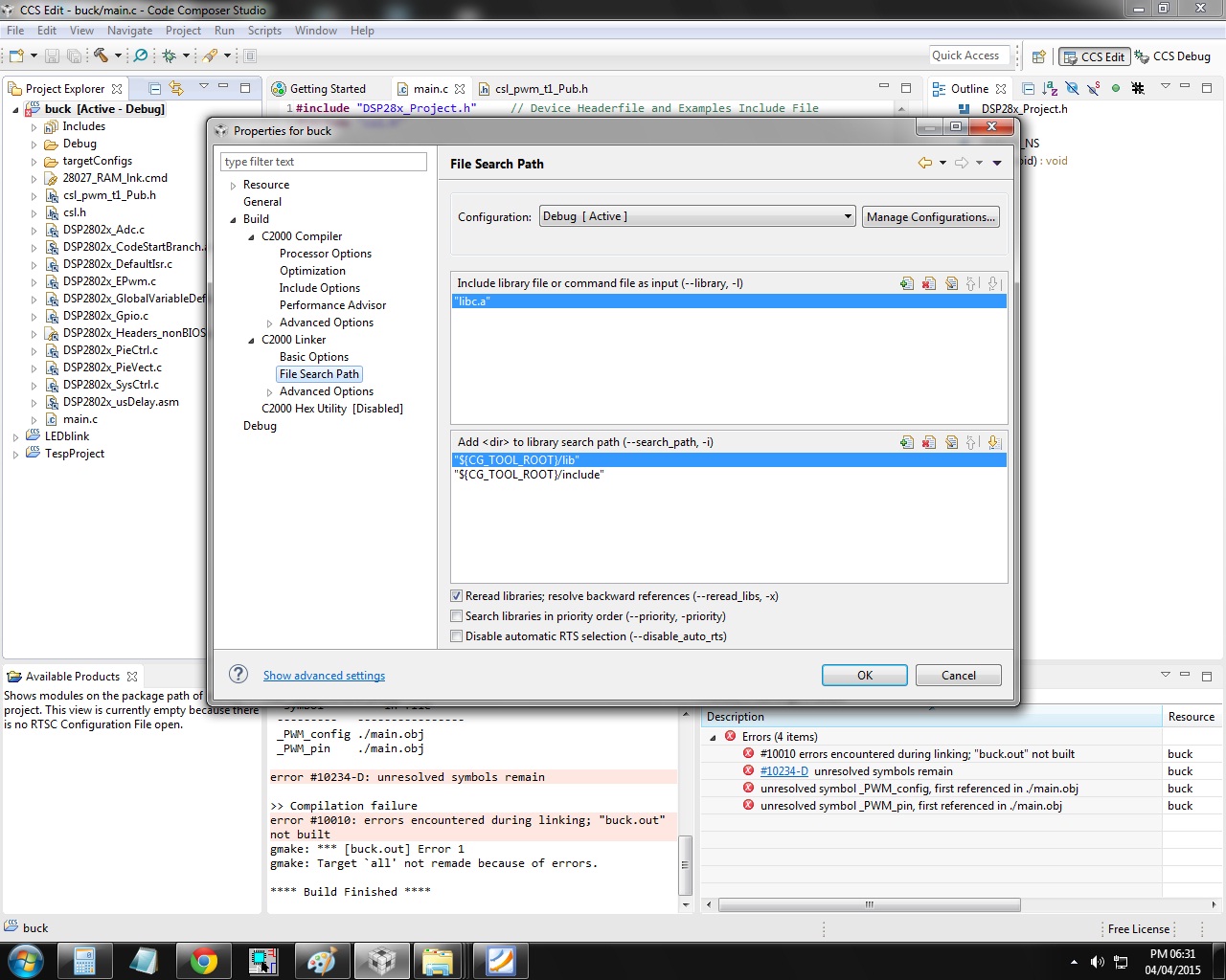

I am working with C2000 Launchpad XL (TMS320F28027) recently. I have downloaded the Biricha CSL library & included the csl.h header file. While compiling a program on Code Composer Studio Version: 6.1.0.00104, I encountered the following problem.

(Please find the attached files for compile & linker option seleced)

    Thank you for the detailed post! Based on the error you provided, the "csl_c2802x.h" file looks to be referencing the "DSP2803x_Comp.h" header. Shouldn't that be referring to the "DSP2802x_Comp.h" since you are using the F28027? Code composer isn't going to find the "DSP2803x_Comp.h" in your current include search paths since they only reference f2802x locations.
    Let me know if that helps!
    Chris
  • hi,
    your first error (which you seem to have fixed yourself) is due to the csl header files being configured for c2803x instead of c2802x.
    The csl headers are configurable with a compiler directive.
    In your case you need to add CSL_C2802X as a predefined symbol.
    Your second error is a linker error since you haven't linked the csl library in to your project. You need to add a link to Ti\controlSUITE\libs\csl\latest\lib\csl2802x_ml.lib
    To add a link right click on your project, Add Files, Ti\controlSUITE\libs\csl\latest\lib\csl2802x_ml.lib, Tick "Link to Files", "OK"
    hope that helps.
    cheers
    Chris

  • As Chris said, make sure to add CSL_C2802X as a predefined symbol in your CCS project. I am not familiar with the CSL library but it seems the "csl_c2802x.h" header would be the one you need and not "csl_c280x.h".
    Chris
  • hi,
    the software is designed to remove much of the hassle of supporting multiple platforms, so the idea is that you only need to include "csl.h" with the correct compiler directive (eg CSL_C2802X) and magically everything will work ;-)
    The internals of the library also use CSL_C2802X for internal configuration (see csl_uart_t0_Pub.h), so its best to include "csl.h" with the required platform, eg CSL_C280X, or CSL_C2802X or CSL_C2833X or CSL_C2803X or CSL_C2806X.
    This allows you to develop on one processor and then quickly change to another.
    The problem you have is at the linker stage since you have not linked to csl2802x_ml.lib. This can be found at C:\Ti\controlSUITE\libs\csl\latest\lib\csl2802x_ml.lib
    To add a link right click on your project, Add Files, c:\Ti\controlSUITE\libs\csl\latest\lib\csl2802x_ml.lib, Tick "Link to Files", "OK"
    You can download a document (BAN106.pdf) detailing how to set up a project with csl from Biricha using the following link, but you will need to register (it's free to do)
    www.biricha.com/.../21
    If you are having problems can you please clarify what error you are getting, since in your original post you started off by saying it was a compiler error, but your screen shots showed a linker error.
