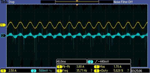

Hey
I'm using the TI highpower pfc motor kit (the main board is yellow not green ). I programed a open loop V/H control using HVIC (the 0.25hp one ). From the scope i can see my current is in good shape sine wave. However if i attach a scope to the ADC A1 and ADC B1 i only got a DC signal around 1.3v. i studied a bit from the PCB file contained in the control suite the R1 in M1 should connect to R28 in M5 and R2 in M1 should connected to R26 in M5. However I tested the board with my mutimeter, on my board they are not connected. Can some body help me out please???
BTW the ADC A7 B7 B6 B4 feed the voltage back just fine
