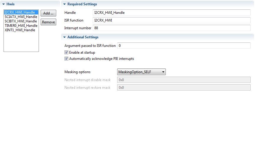

I have gotten I2C Read to work by polling but now I'm trying to replace that and generate a read interrupt.
I have configured the I2C registers as follows:

 I2caRegs.I2CIER.bit.RRDY = 1; // Enable RRDY interrupts

I have created the following code to read from I2C buffer as follows:
unsigned char i = 0;
I2caRegs.I2CSAR = 0x0004;
I2caRegs.I2CCNT = 2;
I2caRegs.I2CMDR.all = 0x2C20;
for(i=0;i<2;i++)
 data[i] = I2caRegs.I2CDRR;
I2caRegs.I2CSTR.bit.RRDY = 1;
It doesn't seem to be call the interrupt. What am I doing wrong?
