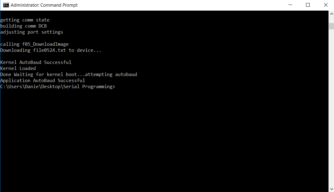

  • Hi Fulano,
    Thanks very much for the help. I think that I have the BT module connected because it shows that  "Kernel Loaded". However, it met a problem that after it shows "Application AutoBaud Successful", then serial programmer exits without printing any error and the program is not burned into the unit.
    Have you ever met similar problem?
    Dan
  • Is the Piccolo locked with a password? Perhaps you should connect oscilloscope to see what is exactly getting sent. The flash kernel may fail when attempting to do Flash_Erase() if the flash is locked with CSM.
  • Thanks for the suggestion. However, when I used a FTDI chip, everything works fine. It is only when I want to use the bluetooth to replace the cable, the programming has some problem.
  • And may I ask which bluetooth module did you use?
    Dan
  • I used BTM411 (discontinued).
    I would check to make sure the baud rate is correct on BT module.
