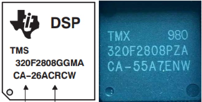

There are three circular dots presents on the top of the microcontroller TMS320F2808.Which one represents the Pin 1.

The device errata shows the pin one location with respect to the device symbolization. In the below it is the dimple in he bottom left corner.
