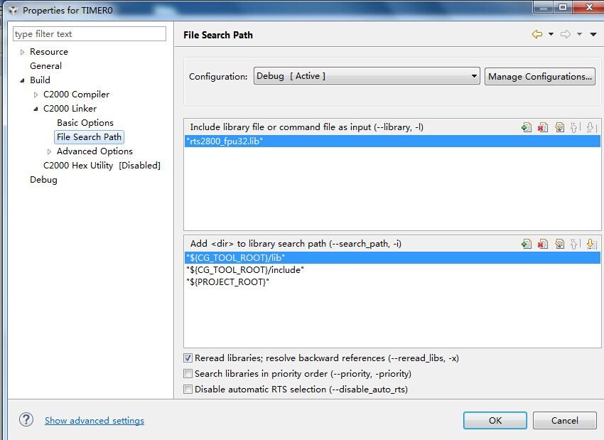

error #10234-D: unresolved symbols remain error #10010: errors encountered during linking; "TIMER0.out" not built
你好,我用的是dsp28335,ccsv6版本,调试的程序是用定时器终端控制流水灯。但是编译程序的时候,出现上面的错误。这是工程的设置以及程序。

  • 哈哈,居然用中文。
  • 你好,
    下面的回复请使用英文,方便美国专家理解你的问题并提供建议。
    我想请问的是,你程序里unresolved symbols中的symbols究竟是哪个symbol?
    你可以将编译时下方console窗口里的相关内容(特别是红色标注的部分)截取出来,或者全选后拷贝发出来,然后可以根据这个信息去搜索你的程序中与这个symbol相关的代码,找到问题所在。
    Please use English to reply in your next post, which will be helpful for U.S. expert to understand your question and give you suggestions.
    My question is, which symbol exactly is it in your project when it reported "unresolved symbols".
    You can simply captured related contents in the console window (especially red indicated session) when compiled or select all and then copy entire compile information to post it here, and then you can search your project to find all codes where the symbols are existed to find the root cause.
    Ricky Zhang
  • hello
    just now。 I had same problem 。the solution is an follow, I hope that will be helpful. find project-right click the mouse-click properties-build-Advanced Options-Symbol Management (Delete code-strat),OK, it wll successful. I love the Chinese!
