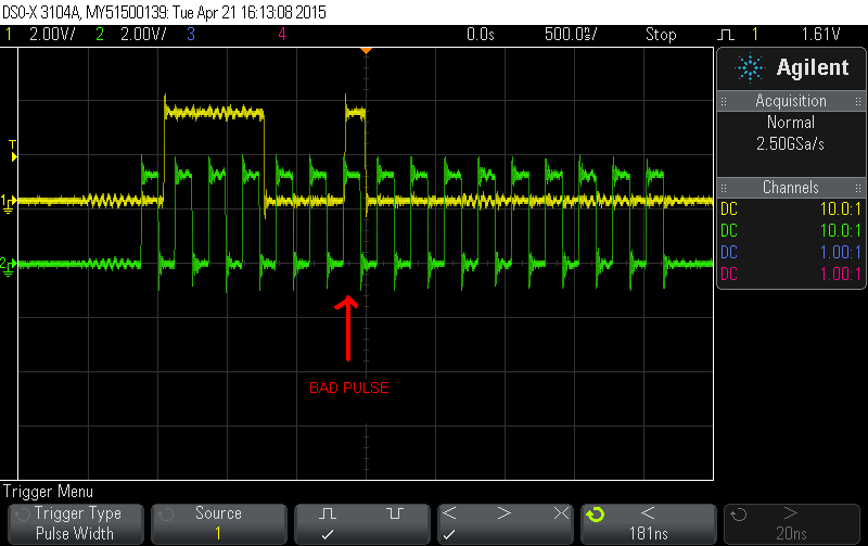

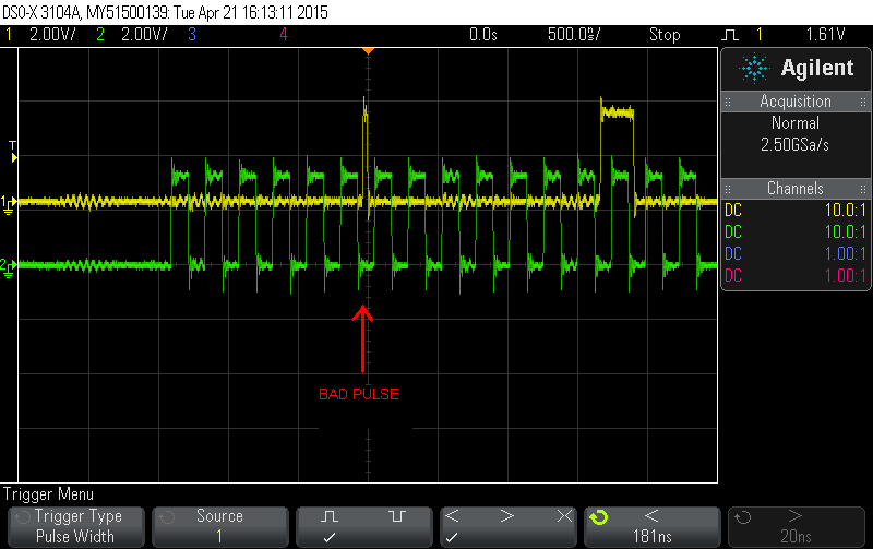

Hi, I've got a problem with a 2808 SPI interface being used as slave. The problem is that occasionally there are extra pulses on the SOMI line that cause erroneous data to be received by the master. The strange thing is that this situation only occurs SOMETIMES after a power on reset. On one power up the data would be good for an entire session, after another power up the data gets these erroneous pulses and continues to have these pulses during the entire session, but they don't occur in every word. There is no difference in the way the power is cycled in either case.
 My slave SPI in the 2808 is setup for rising clock edge with 1/2 cycle delay before the rising edge, 16 bit data, Tx FIFO disabled. In the attached plots there are good pulses and bad pulses (labelled) showing the data and corresponding clock edges. I have also tried the SPI GPIO pins configured as sync and async modes with no difference. Also, the changing the master clock speed makes no difference.
It's my understanding that in SPI slave mode the only way data can change is with master clock edges. That doesn't seem to be the case here and the data changes at times other than the falling clock edge.
In the plots below, trace 1 yellow is SOMI (from 2808), trace 2 green is SCLK (from master). These plots are taken very close to the DSP pins.

    Disconnecting SOMI has no effect. I was able to get it to fail on my setup after many power cycles. Here's what I'm seeing. When the fault occurs, it appears the output register gets loaded a new data word mid-stream. This seems to be the case because the next 16 clocks output the correct sequence of 0101 x 4 even though it ends up finishing mid-word of the next word.  The two scope shots show what I mean. The first scope shot shows the fault mid-word. Then counting the next 16 clock pulse, overlapping into the next word, the patter of 0x5555 is correct. The sequence is now off by 8 clock pulses.
    How is it possible to overwrite the TxDAT register if I'm only writing to the TxBUF register? Is this a bug in the DSP?

    It was discovered that the master device was occasionally transitioning the clock line before the system was fully up and running. Since the Slave (F2808) was not using the SPISTE, the spurious clock pulses corrupted the internal bit counter inside the Slave, causing it to lose synchronization.
    The recommended workaround for any application not using SPISTE (SPISTE is tied to ground, always active) is to periodically toggle the SPISWRESET bit to reset the SPI state machine, bit counter, and flags. If the SPI had lost synchronization due to spurious clock pulses, this method would provide a way to re-sync the communication.
    The resolution for this poster's startup problem was to do a SPISWRESET after the initialization of both devices, but before the master would start communicating.
