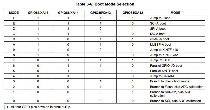

How to force a Boot Mode selection for F28335.
Hi TI guys,
GPIO pins 84, 85, 86, 87 can be set as a input, output or XA. Those foour pins allow selecting the boot ROM mode. If all of them are set to high value the boot jumps to flash (TMS320x2833x, 2823x Boot ROM SPRU963A). I have a question, what configuration (input, output, XA) do I have to set to select the boot mode? why those four pins (84 to 87) are named GPIO if thay can not be used as a input or output since their fuctions is to set the boot mode?
