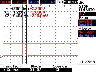

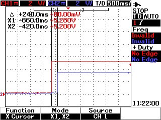

I have performed the following measurements:
  • From power on (CH1) to XRS (CH2) signal high there are about 240msec
  • During the watchdog reset (CH1 monitors my debug GPIO set high upon command to let watchdog expire) the XRS (CH2) signal remains high
Per TI documentation the XRS signal is supposed to go low for 512 OSCCLK.  But this does not happens.

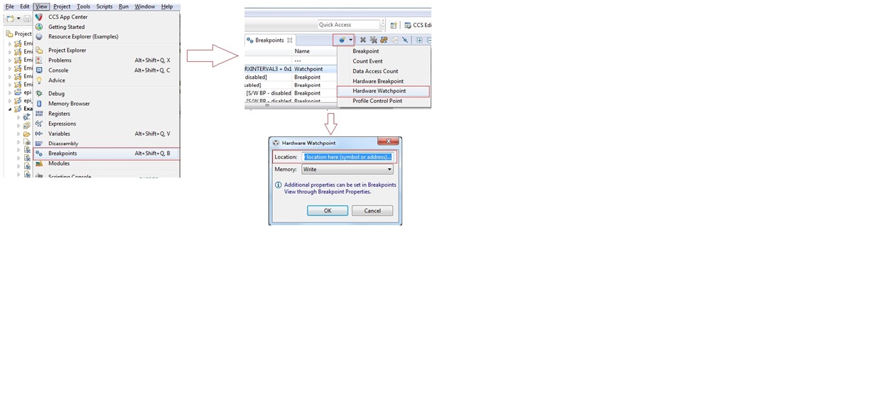

    How can I determine if there is any library/device initialization code clearing the WDFLAG before my application can inspect it?
    How can I trap writes to the WDCR via Code Composer?

  • Hi Rafel,
    In CCS you can use "Hardware Watchpoint" feature for this. Following is the step for the same.
    In CCS click on "View" -> "Breakpoints". In breakpoint menu click on drop down menu and then choose "Hardware Watchpoint" and enter the address for which you want to trap the writes and click "Ok".

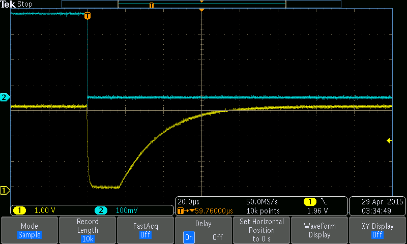

  • Hi Adam,
    The wiki you pointed to has a better description of how the WDFLAG is supposed to work. However based on this augmented information and the measurements that we are taking the timing in our system seems correct, but the WDFLAG remains at 0 at all times.
    Here is a measurement of the XRS (CH1) and a GPIO (CH2) that we turn on when the Watchdog is enabled during the power up initialization.
    At time T the watchdog expires and creates a reset making both signals go low.  The XRS signal stays low for about 17usec which is what we expect for 512 cycles with a 30MHz OSCCLK.  The XRS signal goes back to high in at most 80usec.  Based on the wiki you pointed to the WDFLAG should go high if XRS is high before 1.1 millisecond ( (8192 * 4) + 512 cycles of 30MHz OSCCLK) after the watchdog reset occurs.
    The Wiki you pointed to is specific to the Picolo processor.  We are using the Delfino family.
    Questions:
    • What is the XRS sample delay after a WDRST for the Dolfino?
    • Is this delay fixed based on hardware or is it configurable by software?
    • Any suggestions on how to troubleshoot this issue?
    Thank you,
    Rafael
  • Rafael,
    The F2833x watchdog is the same one used on Piccolo.
    How long after reset are you waiting before you try to read the WDFLAG bit? With your OSCCLK, the bit will not be valid until ~1.1 milliseconds after reset.

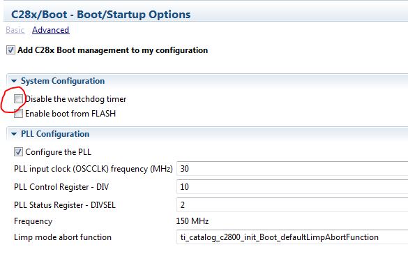

    Our application code was correct and so is our custom board.
    Using this Hardware Watchpoint we were able to trap and trace back to a board initialization library as the culprit of our issue.
    This function ti_catalog_c2800_init_Boot_disableWatchdog during boot disables the watchdog writing 0x00E8 clearing the WDFLAG.
    Via the Boot/Startup Options we unchecked the Disable the watchdog timer option and problem solved.  Now the WDFLAG stays on after a watchdog reset.
    Thank you.
