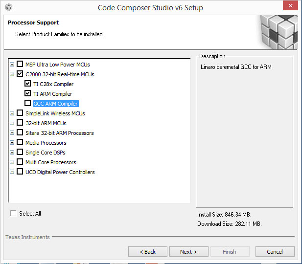

    No updates are available. I was wondering if I may have not selected some additional installation during setup?
    Here is what I had installed.
    Bruce
  • you should have everything you need.
    I've seen this happen a few other times and I believe it usually ends up being a bad installation or a corrupted workspace.
    try opening CCS and starting a new workspace.
    if that does work, try uninstall / re-install CCS
    here is a thread that is similar
    e2e.ti.com/.../1277975
