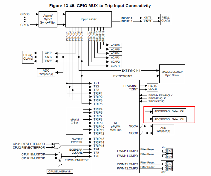

  • But why does the dsp have a dedicated ADCSOCBO pin on GPIO10? Can't I just use this pin directly? Instead of using the OUTPUTXBAR.
    I also found the following two outputs from the ePWM modules. But I can't find ant documentation on these signals (marked in red):

    Still I wonder what the above outputs marked in red are, and where they are documented.
  • Hi Erik,
    You are right, there is also a GPIO mux connection.  I forgot about that. :)
    The ADCSOCxOn Select Circuit (the section you marked in red in your picture) outputs [1] to the GPIO mux and [2] to the OUTPUTXBAR.  I agree this is not documented as well as it could be, and I will file a documentation change request for the TRM so that this gets clarified in a future revision.
