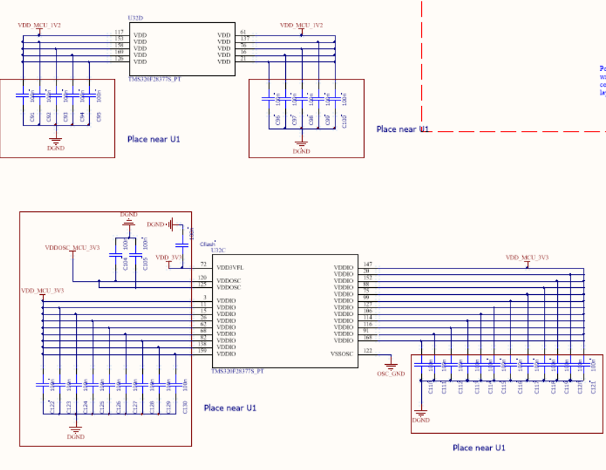

I designed a custom board, referring to the 28377d control card schematics.

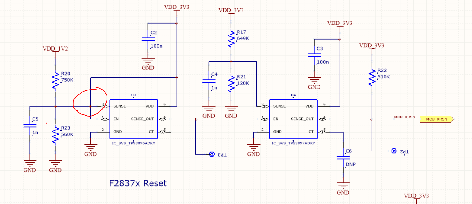

Another issue is about the reset signal XRS and Error pin ERORSTS. I find XRS will toggle with 920 us high level and 40 us low level, and ERORSTS toggles with 920 us low level but 40 us high level correspondingly.
Then, I test TI control card. Its XRS also toggles but with16 ms high level and 40 us low level, and ERORSTS is zero voltage.
I am not sure why this happens and how to explain my issues and solve them.
I already re-solder two DSP chips on my board, and the same issues occur. And all the power pins VDDIO, VDD and VDDA have stable voltage 3.3v and 1.2V. so, I don't think it is because of the improper soldering.
