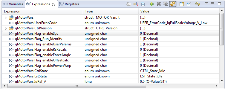

I am still poking around a bit with the example project provided with the kit. And everything onward from project 3a does not want to run.
I can place "Run_Identify" on 1 but "enableSys" never wants to change of value for some reason. It always flips back to 0 when I try to enter a 1 as shown below.
Any Idea how I can make the labs run?
