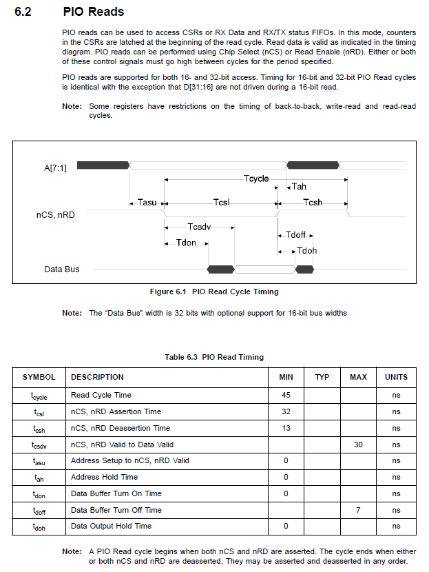

    I want to read:
    Unfortunately I cannot read anything. All data pins stay low :(
    What am I doing wrong?

    Best thing would be to capture the waveform using logic analyzer and check the value on address bus and timing of control signals.

    Also please scope out all the address pins and CS from MCU and see if the address pins are able toggle properly. For ex: you put 0x5A5A and 0xA5A5 on the address and see the pins being set properly.
