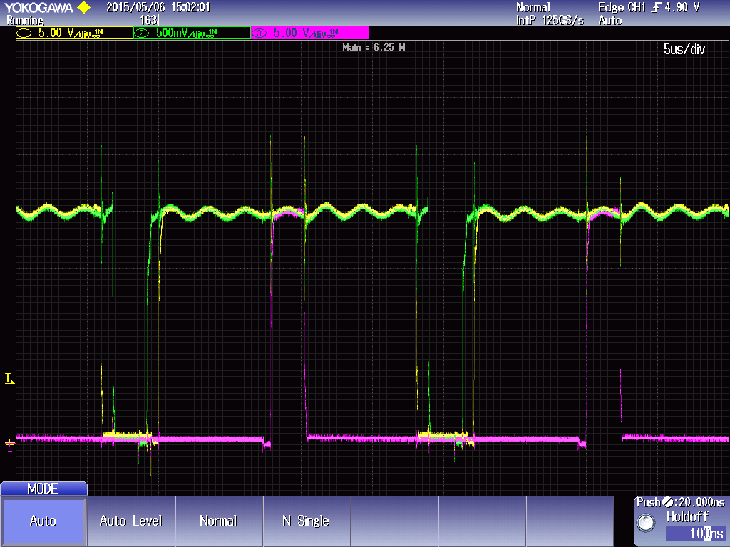

The problem is that at initializiation the 3 fase lie on top of each other. And then the move to there 3 phase position. Only they don't stop at the max current position. They go to the max position.
So I guess I have a problem with my current feedback. I can't find the part that is responsible for the motor initialization and which variable is used for the current feedback. Can someone please point me at in correct direction.
 Thanks.

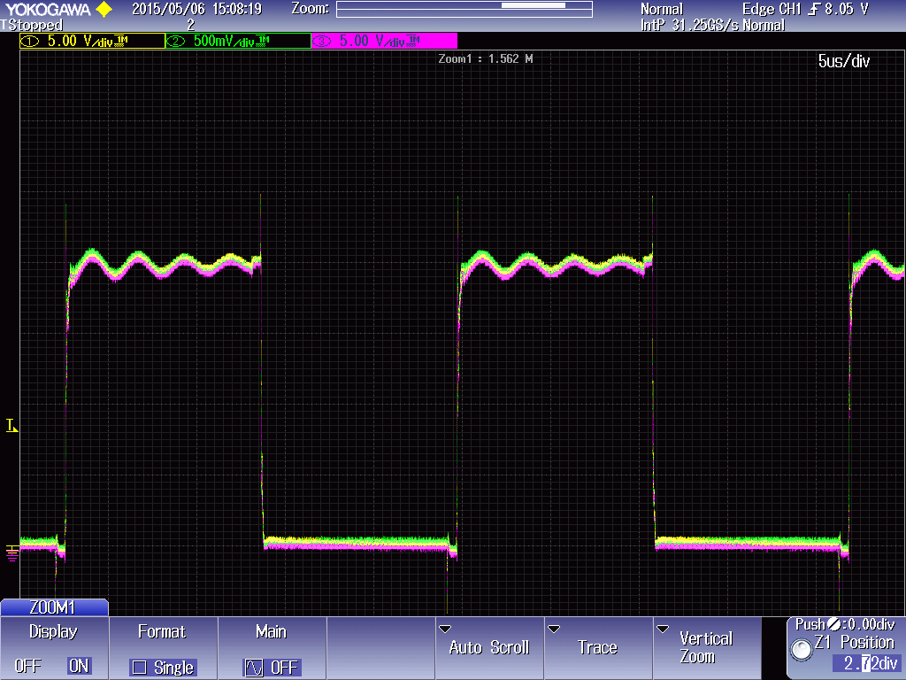

  • That is the third time you tell me to read chapter 5. That is a very basic description. Please give tell me a  technical answer how to verify my current feedback is correct.
    I show the problem with these picture: At start up initialization CTRL_State_OffLine:
    At EST_State_Rs:
    There is a max offset between the pfases. So the feedback loop is not correct. If I look at:  intr_obj.ctrlHandle->Idq_in.value[0] I see the current value I (more or less) I Expect. So I think they is a problem with the fbackValue value. (in CTRL_runOnLine).  So I'm there at the moment.
     NOTE: Green is also 5V per div. The attenuation is not set correctly.
  • all I can recommend is checking your HW, checking your calculations, verifying the software settings match, verify offset bias is reasonable, verify proper amount of current is being observed during RoverL (1/2 of the RES_EST_CURRENT)
