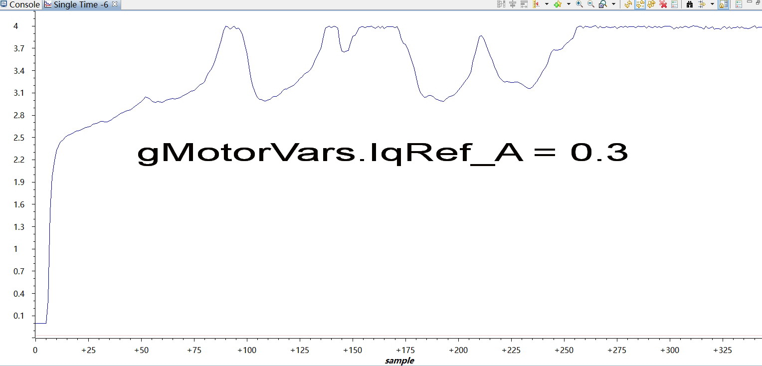

I used DRV8301-69M-KIT board to run the motor (LVSERVOMTR )by torque control in lab05a. When I set gMotorVars.IqRef_A = 0.2,the speed was stable(It was about 1000RPM).But when I set gMotorVars.IqRef_A = 0.24,the speed was mutational(Sometimes it was up to 6000RPM)! ! As shown:
I don't know what caused that.
  • lab05a doesn't have a speed controller, so with no load once you have enough of a torque command it should reach it's maximum speed. there are torque values which will keep the maximum speed relatively low, then just a small increase from that torque command will allow the motor to go to maximum speed.
    I'm still surprised to see the speed varying so much. Looks more like a variable load was applied/removed.
    this was all unloaded?
  • this was all unloaded?
    The motor run in the no load condition.

    I don't have a DRV8301 EVM in my office right now, but I tried LVSERVOMTR with BOOSTXL-DRV8301 and LAUNCHXL-F28069M using 24Vdc bus with NO LOAD.
    Iq_Ref_A < 0.28 A: rotor doesn't start-up, just oscillates
    Iq_Ref_A = 0.28 A: rotor starts up and runs at 900 RPM +/- 40 RPM (remember, there is no speed control, just a maximum Iq current command)
    Iq_Ref_A = 0.30 A: 1110 RPM +/- 40 RPM
    Iq_Ref_A = 0.40 A: 2170 RPM +/- 40 RPM
    Iq_Ref_A = 0.42 A: 4400 RPM+ saturates, increasing Iq_Ref has no effect on no-load speed

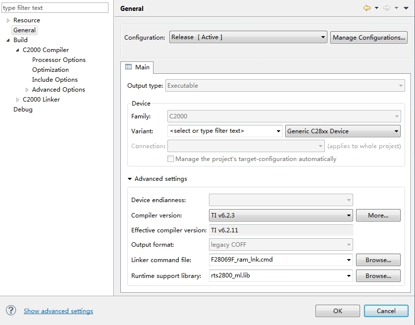

    can you confirm which EFFECTIVE Compiler is being used when you build this project?
  • Tomorrow,I will do some repeat experiments to observe the speed 、check the compiler version and upload user.h.

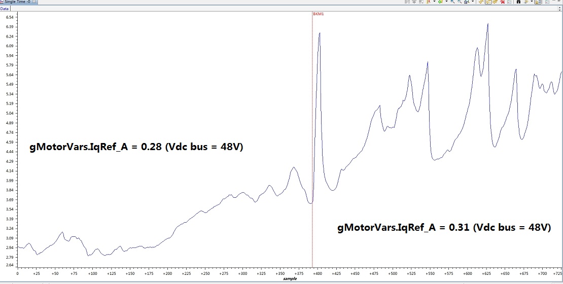

    It was saturated because bus voltage(24V) was too low.If I make bus voltage 60V and I set gMotorVars.IqRef_A = 1,the LVSERVOMTR  can run up to 9000RPM.
    Today,In order to rule out other problems,so I have re-installed CCS5.5 and MotorWare14 then identified the motor parameters again in lab02b and lab03a.
    I have done some repeat experiments to observe the speed at different bus voltage level.Get some experimental data in lab05a:
    My compiler and CCS version:

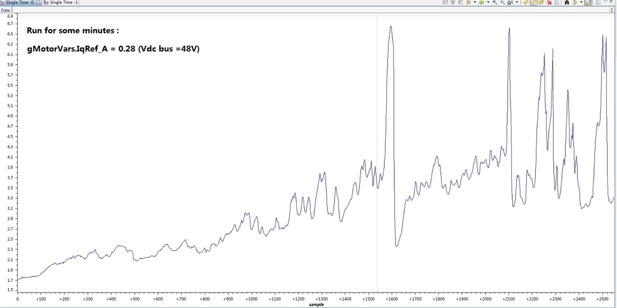

  • I did another test : I set gMotorVars.IqRef_A = 0.27 and made motor run some time (more than 10 minutes) then observed the changes of velocity.

    I can't duplicate your results...the speed drift over time happens and I think that's related to the Rs increasing slightly (although there isn't very much current)...but I never get unstable speeds like you are showing.

    In my no load tests, when a new Iq command is given the speed increases stable to a new speed. It then oscillates around +/- 40 RPM and slowly drifts higher. I never see any wild accelerations / decelerations and instability like you are showing.

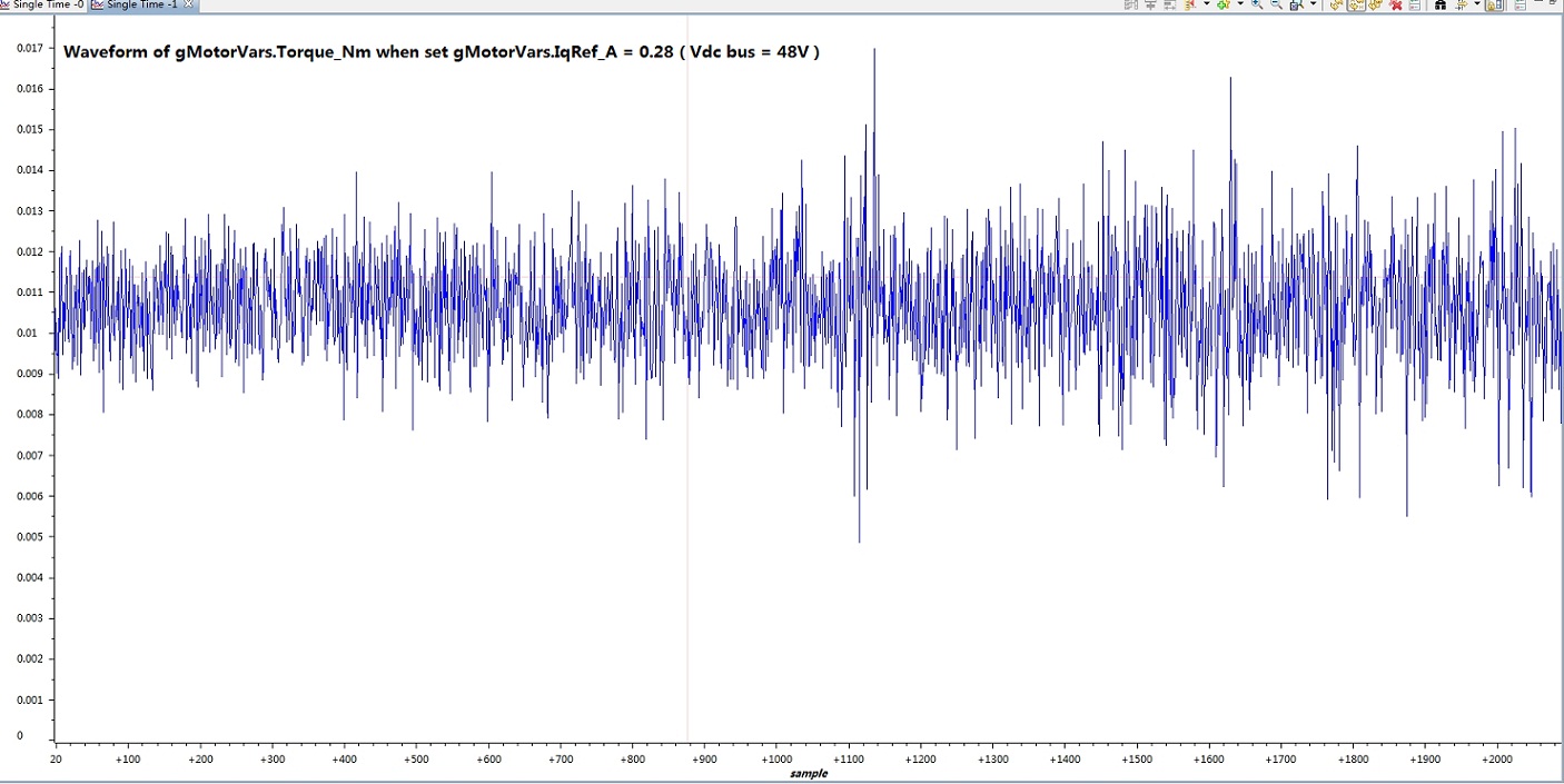

    Experimental data about curve of speed from lab05a:
     I suggest that some engineer who have DRV8301-69M-KIT and LVSERVOMTR in TI can do this test to observe the results.
  • I just tried with DRV8301 EVM - but only 24V - and can't duplicate. I never see any spikes in speed..
    what is the time scale on your graphs?
    and the vertical axis is in KRPM?
    when you see the speed "spikes" on your graph, can you observe that the rotor actually speeds up (and then speeds back down) just like your graphs show? This doesn't seem possible. Even if the motor did speed up, since you don't have a load it certainly shouldn't slow back down.
    with 0.28A command my set-up has been running between 1400-1700 RPM for several minutes. No sudden speed changes.

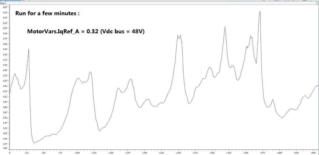

    since I've posted I've let the drive keep running, and at some point it did increase up to 3000 RPM. But it never accelerated / decelerated suddenly like your graphs.
    if I stop/start the drive again and do RsRecal the Rs has increased by 3.5% and the motor goes back to 2200 RPM
    I really don't know the explanation for this...and I'm not even sure this test is valid. When are you ever going to be commanding 4% of the rated current of a motor with no load?
    Yes,the motor not only sped up and back down as data curve,but it was heated if speed was too high.

    thinking more about this, I think the issue is one of resolution.  We are seeing the issue on the DRV8301 EVM (82.5A full scale current measurement) but not on the BOOSTXL-DRV8301 (33.0 full scale current measurement) when commanding 0.2-0.4A
    I think we are running into ADC quantization / low resolution which is effecting the current measurement feedback from such small currents we are trying to control on such a wide range.
    make sense?
  • I do not have  BOOSTXL-DRV8301.So to verify what you said,I can only set two different IqRef_A values(0.3A and 1A) to compare.
    To  prevent LVSERVOMTR  motor over speeding,I added program code about speed limit (4Krpm).Then,I used my user.h to do an experiment.The status is as following:
    We see the motor run well when set IqRef_A = 1.
    Maybe,this result of this experiment can prove you are correct.
