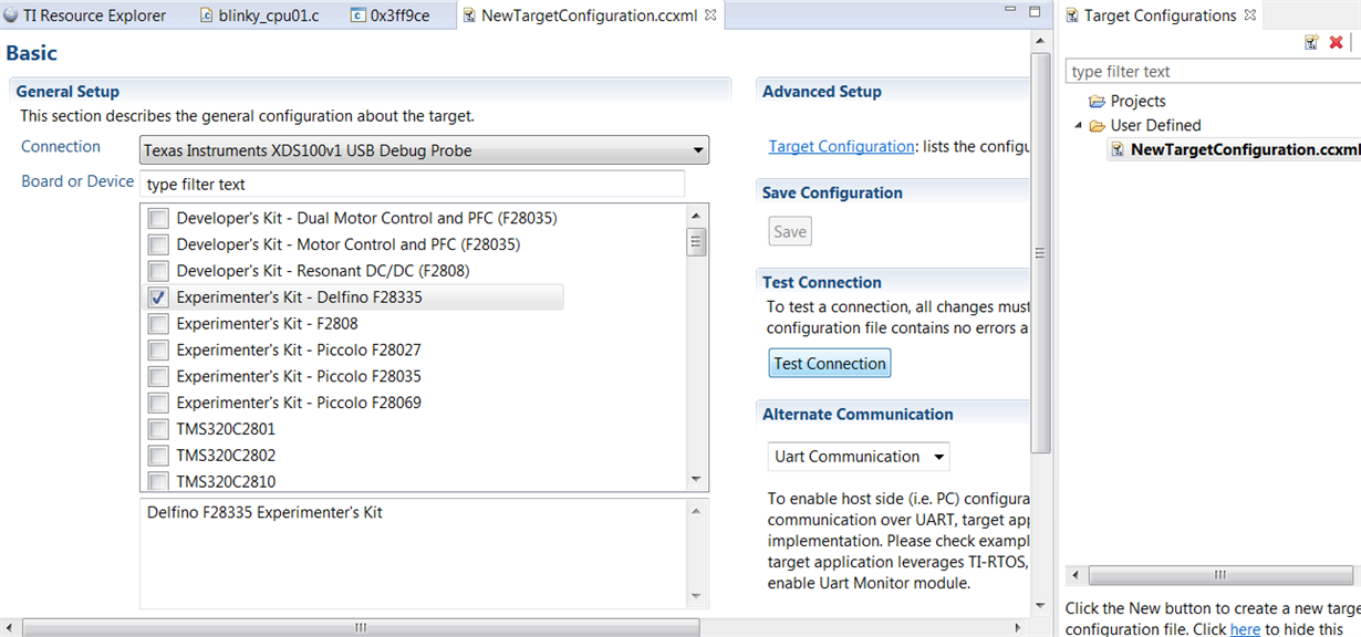

I'm new to CCS. Anyway I did search on the CCS forum and the wiki looking for a solution for my problem, but nothing seemed to work. I have C2000 dock with an F28335 control card. I have installed CCSv6 and controlSUITE, and the necessary drivers on Win7 64. I try to connect to the device the following way:
This is the error message I get when I click on Test Connection:

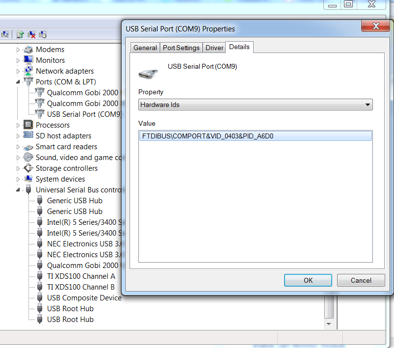

In the device manager everything seems to be installed properly, so I have no idea what is causing the problem. I checked the VID and PID values with xds100serial.exe , and they are correct.
