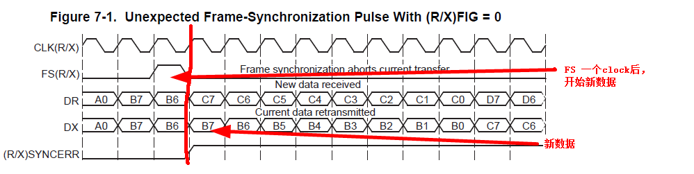

Now I use 28335's MCBSP DMA to receive data from a ADC(ADAR7251), there are 2 channels data on ADC output line,  transfer format is shown in figures. a data array A[2048] is used to store the ADC data:
      DATA1[0]  --  CH1
      DATA1[1]  --  CH2
      DATA1[2]  --  CH1
      DATA1[3]  --  CH2
      DATA1[2046]  --  CH1
     DATA1[2047]  --  CH2
  sometime I found the data is stored as
DATA1[0]  --  CH2
DATA1[1]  --  CH1
DATA1[2]  --  CH2
DATA1[3]  --  CH1
DATA1[2046]  --  CH2
DATA1[2047]  --  CH1
so I can not serperate ch1's data and ch2's data,  what the problems ?   my MCBSP_DMA configuration code are as following

note: frame syn signal is pulse in Figure41
