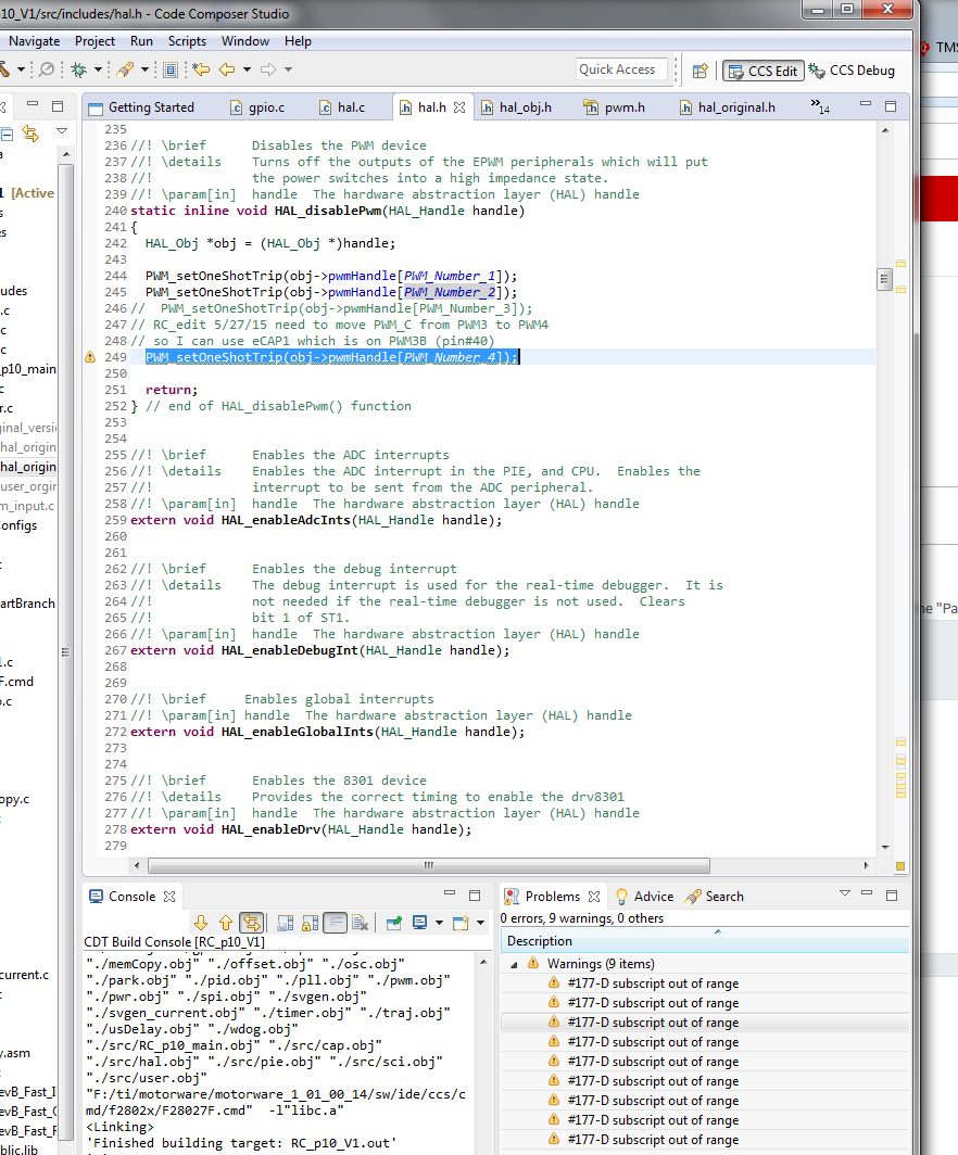

What causes a "#177-D subscript out of range" warning?
I'm trying to move PWM_CH and PWM_CL to PWM4A and PWM4B so I can use eCAP1 on GPIO5/PWM3B (pin#40).  I thought that I successfully modified HAL.H and HAL.C to change the pins but the compiler is giving me multiple warnings:
Any ideas what I did wrong?
Here's a screen grab of the warning:
I apologize if this isn't the correct forum to post this question.
