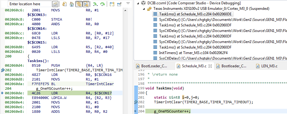

The first time that I enter a timer based interrupt it seems like I have a large stack. The interrupt is the Task1ms and my breakpoint is at the top of the function:
Here is the memory view:
This function is a timer based task (1ms) that is called when Timer A timeouts; this is all configured in InitTImers function:

  • Hi William,
    It looks like you are continuing to enter the same functions recursively Task1ms() and SysCtlDelay(). And this may be causing a problem with your stack. It may be overflowing or corrupted.
    Are you clearing the PIE by writing to PIEACK at the beginning of your ISR? It looks like you are entering the ISR again from inside of the ISR.
    Please see the Peripheral Interrupts section of the Technical Reference Manual for F28M35x.

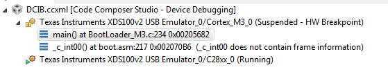

    If I put a breakpoint in the main loop, the stack trace is:
    It really only looks like it is messed up when it is in the context of the 1ms task.  Any suggestions for a test?

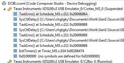

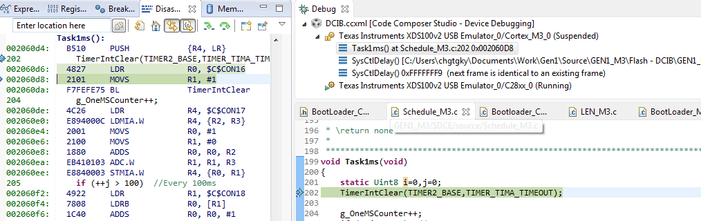

  • Well, this is weird...
    I put a breakpoint at the top of the Task:
    And after single code step...
  • I wonder if there is something up with CCS.
    Did g_OneMSCounter increase the number of times equal to the increase int the depth of the calls in your stack window? With that single step, did g_OneMSCounter increase?
    sal

  • Sal,
    With at least 4 Task1ms() frames on the stack, I only see 1 for the g_OneMSCounter .

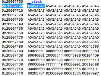

  • Is the stack corrupted with 0xA5? Can you try filling the .stack in the linker command file and see if the stack is being corrupted by these apparent function calls?
    Because g_OneMSCounter is only incrementing by 1, either this is a problem with CCS not displaying the correct calls on the stack or the ISR is being interrupted by the same ISR.
    Do you see the same behavior if you put the breakpoint on "g_OneMSCounter++;" and then single step?
    sal
  • I am using a Linker FILL to place A5 in the entire stack currently.

    Anything past that first step displays the inflated stack. After that one balloon step, the stack behaves as I understand that it should.
  • Yes, IntClear should prevent that. I was asking if by setting a breakpoint on IntClear was causing this problem. If you set the breakpoint on the next statement or a couple of statements below the IntClear, does this problem persist?

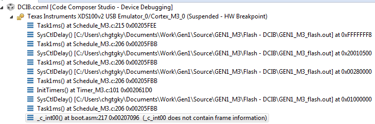

  • Ok, figured out the problem... The stack was moved from the default 0x20004900 to somewhere else. Once I moved it back the problem went away! Apparently, the stack MUST be at that default address.
