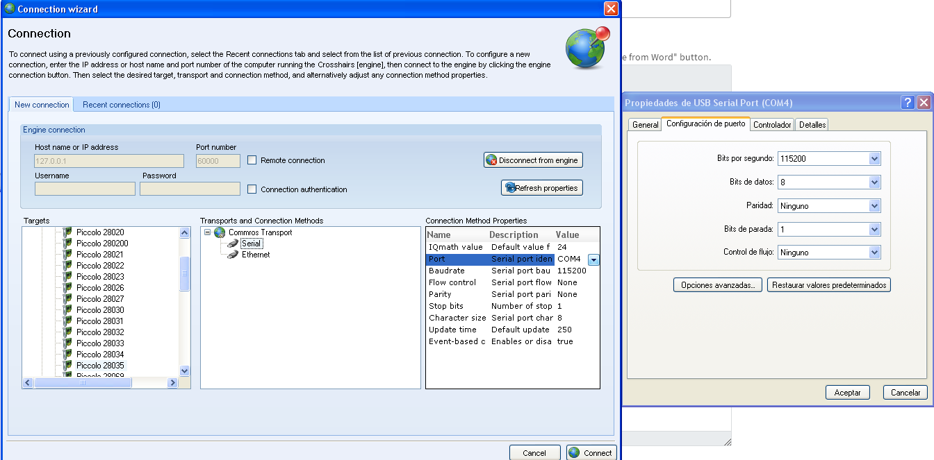

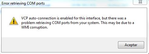

I have the TMDSHVMTRPFCKIT ( pcb yellow color) with the Piccolo F28035 control card and the problem i have is that when I run the  HVMTRPFCKIT-PM-ACI-GUI application it shows me the next error.
I have tried to do de connection manualy with the connection wizard but it can not connect.. Here you have  the configuration I have.
I have to say that I have passed the test connection with the CCSv6 and that the configuration of the switches of the controlcard is the next: SW1: OFF, SW2: ON ON, SW3:OFF OFF and the J9 of the main board is populated because if not the test connection fails so I think it must be populated in order to connect with the computer.

  • Hi Gautam,
    Yes, in fact, I am able to load programs into the microcontroller using CCSv6 so it should connect correctly. I have flashed the controlcard with the file HVMTRPFCKIT-PM-ACI-GUI.out to make sure that the correct program is loaded but I have the same problem. I think that it is loaded correctly because when the microcontroller is suplied the led red (LD3) starts blinking.
    Also I have tried to debug the HVPM_Sensored project but I can´t do that. I think that the program is not running when I try to debug because the LD3 doesn´t blink.
    I have followed the guide which is in the folder you told me so I really don´t know what I´m doing wrong.
