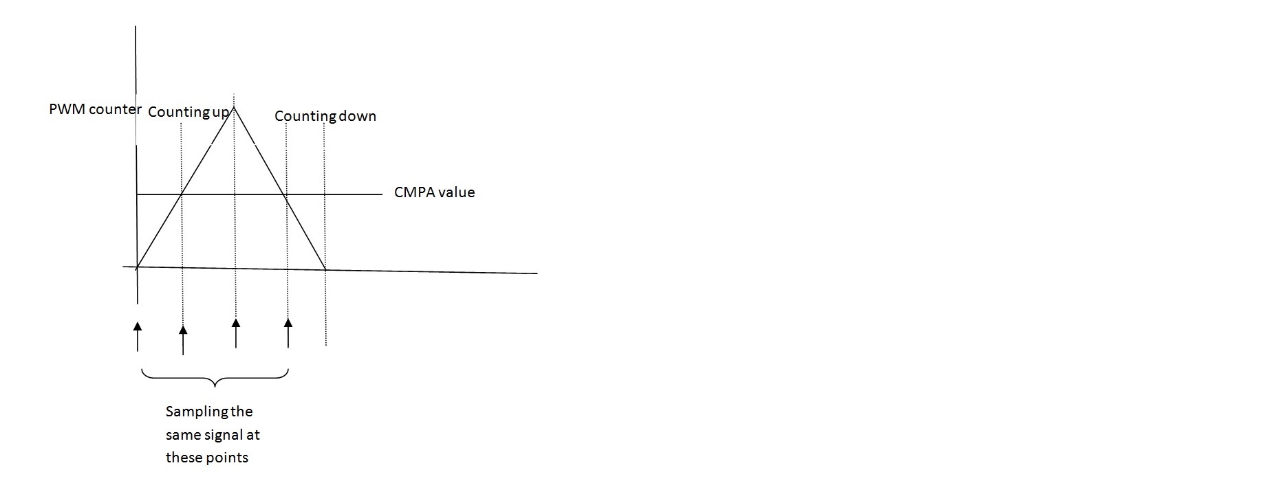

    I have to sample only one channel. I need four samples of input within a PWM cycle i.e. at t=0, period , at CMPA increasing and decreasing. . triggering event could be epwm timer . I am writing the code which i have written but not working.
    Waseem

  • i need to sample same voltage at different instant
    Here is a diagram explaining what i needed to achieve.
