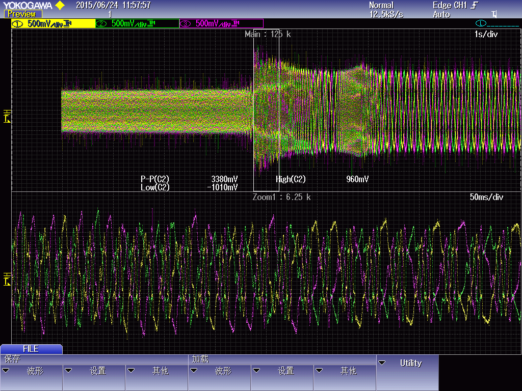

instaspin foc, abnorml current waveform,application in water pumper.
Other Parts Discussed in Thread: MOTORWARE
I’m testing a BLDC,AC 230V in, 2HP, 8 poles,2850RPM rated,application in water pumper.  hardware referenct HVKIT. use mcu 28027F.
motorware version: motorware_1_01_00_14
ccs  Version: 6.0.1.00040.
the following figure is an abnormal wave. in the cause of the water pumper acceleration. use lab09.

what happend at that moment??? Many tests are like this. The pump is normal, there is no block.
  • Hello Tony,
    Right before you loose control, there are signs that the controller is going unstable. You can see this from the oscillations in the current waveform amplitude. I have a few questions and suggestions:
    1. What does the Iq reference waveform look like right before you lose control? If it is stable, then the problem is most likely with the Iq current PI controller itself. Try lowering the PI gains in the current controllers.
    2. What does your speed signal look like? I suspect it is oscillating in sync with the current waveform amplitude right before you lose control. If so, try lowering the P and I gains of your speed PI controller (especially the P term). In most cases, the current controllers are stable and it is the speed controller that needs to be tuned better.
    3. What happens if you lower the acceleration rate?
    4. What does your bus voltage look like? As the speed increases, you are requiring more power from the bus as a function of speed squared. If your bus caps are too small, you might be seeing some bus ripple that could be contributing to this. Or, you may get into an unstable situation where you are sloshing energy back and forth between your bus caps and the inertia of the motor/load.
    Please let me know what you find.
    Dave

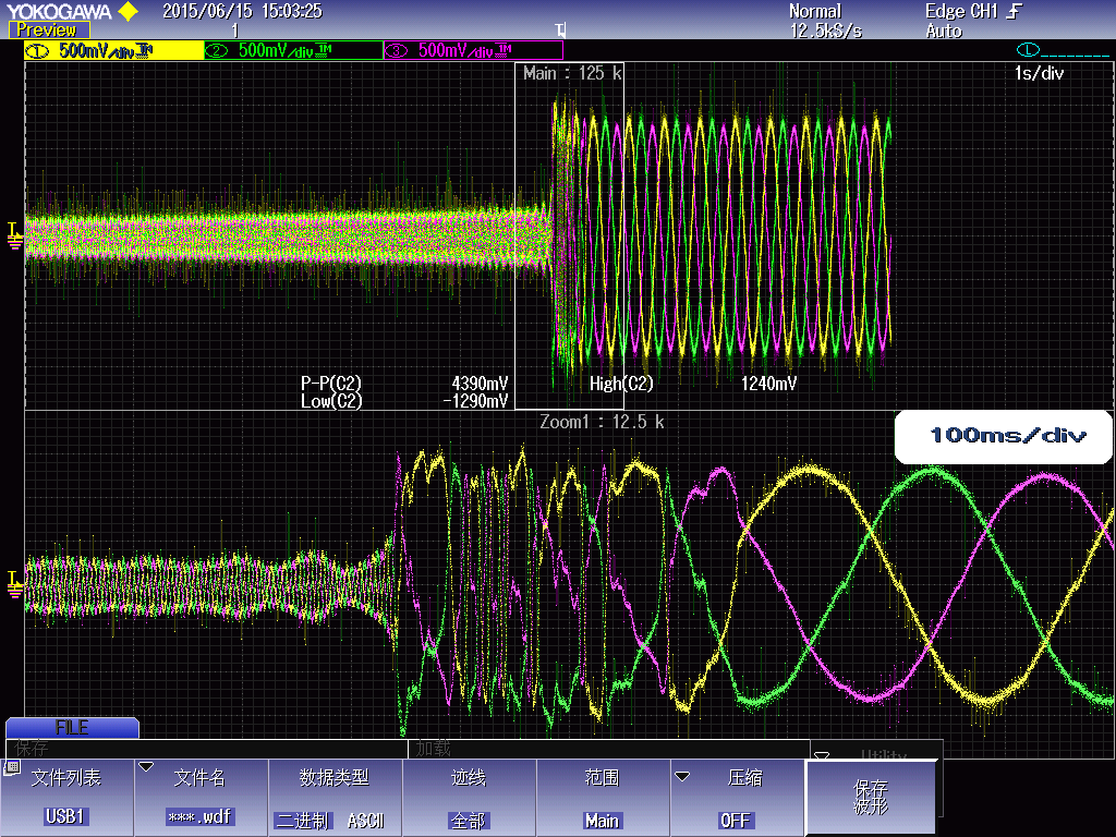

  • hi dave,
    1. I used to change the kp_spd lower,but no effect. now is about 4.0
    2. I record the screen to show you.
    start up with on load about 3 n.m.
    I can see that the speedTraj_Krpm is not equal Speed_Krpm at that moment.
    and the waveform like this:
    thanks.
    best regards.

  • Hi Tony,
    Thanks for collecting this data.  Yeah, I can see that right around 2300 RPM, the speed drops like a rock and the current waveforms look pretty ugly.
    What happens if you lower the speed gain to something extremely low, like 0.5 or 1?  Does it make any difference?
    Also, I would very much like to see plots of Id_ref, Id, Iq_ref, Iq, Vd and Vq using the CCS plot feature if possible.  I suspect your current feedback reading may be contaminated, and I'm hoping I can see that on these plots.
    What is wierd about this is that once you lose control, the system seems to settle down to a stable but lower speed operating mode.  Usually when control is lost, it doesn't find another stable operating mode like this.  Is the motor spinning when this happens?  Does it feel like it is being controlled, or is it like the controller is locked up?
    Also, I see that Iq is zero.  I suspect you just don't have real-time updating set for this variable, but I just wanted to mention it.
    Dave
