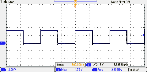

I am using 32 bit tms320f28335 to generate pwm for my single phase inverter. I am actually facing problem during 10 kHz pwm generation.
I set values to TBPRD register for all frequencies above 11kHz and got the accurate result but my oscilloscope is just showing 1.0 kHz when i try to generate 10kHz or a lower frequency.
CPU frequency is 150 Mhz and sampling time is 100 usec. Values for register to generate 10kHz is 7500.
I need some suggesstions and help to solve this issue.

  • Moiz, here's the code for ePWM up count for 10KHz. I've edited the example code present here :
    C:\ti\controlSUITE\device_support\f2833x\v140\DSP2833x_examples_ccsv5\epwm_up_aq
    TBPRD = 3750 // 10KHz for ePWM1
    Here's are the waveform and code file:

       epwm2_info.EPwmRegHandle = &EPwm2Regs;           // Set the pointer to the ePWM module
       epwm2_info.EPwmMaxCMPA = EPWM2_MAX_CMPA;         // Setup min/max CMPA/CMPB values
       epwm2_info.EPwmMinCMPA = EPWM2_MIN_CMPA;
       epwm2_info.EPwmMaxCMPB = EPWM2_MAX_CMPB;
       epwm2_info.EPwmMinCMPB = EPWM2_MIN_CMPB;
    void InitEPwm3Example(void)
       // Setup TBCLK
       EPwm3Regs.TBCTL.bit.CTRMODE = TB_COUNT_UP; // Count up
       EPwm3Regs.TBPRD = EPWM3_TIMER_TBPRD;       // Set timer period
       EPwm3Regs.TBCTL.bit.PHSEN = TB_DISABLE;    // Disable phase loading
       EPwm3Regs.TBPHS.half.TBPHS = 0x0000;       // Phase is 0
       EPwm3Regs.TBCTR = 0x0000;                  // Clear counter
       EPwm3Regs.TBCTL.bit.HSPCLKDIV = TB_DIV1;   // Clock ratio to SYSCLKOUT
       EPwm3Regs.TBCTL.bit.CLKDIV = TB_DIV1;
       // Setup shadow register load on ZERO
       EPwm3Regs.CMPCTL.bit.SHDWAMODE = CC_SHADOW;
       EPwm3Regs.CMPCTL.bit.SHDWBMODE = CC_SHADOW;
       EPwm3Regs.CMPCTL.bit.LOADAMODE = CC_CTR_ZERO;
       EPwm3Regs.CMPCTL.bit.LOADBMODE = CC_CTR_ZERO;
      // Set Compare values
       EPwm3Regs.CMPA.half.CMPA = EPWM3_MIN_CMPA; // Set compare A value
       EPwm3Regs.CMPB = EPWM3_MAX_CMPB;           // Set Compare B value
       // Set Actions
       EPwm3Regs.AQCTLA.bit.CAU = AQ_SET;         // Set PWM3A on event B, up count
       EPwm3Regs.AQCTLA.bit.CBU = AQ_CLEAR;       // Clear PWM3A on event B, up count
       EPwm3Regs.AQCTLB.bit.ZRO = AQ_TOGGLE;      // Toggle EPWM3B on Zero
       // Interrupt where we will change the Compare Values
       EPwm3Regs.ETSEL.bit.INTSEL = ET_CTR_ZERO;     // Select INT on Zero event
       EPwm3Regs.ETSEL.bit.INTEN = 1;                // Enable INT
       EPwm3Regs.ETPS.bit.INTPRD = ET_3RD;           // Generate INT on 3rd event
       // Start by increasing the compare A and decreasing compare B
       epwm3_info.EPwm_CMPA_Direction = EPWM_CMP_UP;
       epwm3_info.EPwm_CMPB_Direction = EPWM_CMP_DOWN;
       // Start the count at 0
       epwm3_info.EPwmTimerIntCount = 0;
       epwm3_info.EPwmRegHandle = &EPwm3Regs;
       epwm3_info.EPwmMaxCMPA = EPWM3_MAX_CMPA;
       epwm3_info.EPwmMinCMPA = EPWM3_MIN_CMPA;
       epwm3_info.EPwmMaxCMPB = EPWM3_MAX_CMPB;
       epwm3_info.EPwmMinCMPB = EPWM3_MIN_CMPB;
    void update_compare(EPWM_INFO *epwm_info)
       // Every 10'th interrupt, change the CMPA/CMPB values
       if(epwm_info->EPwmTimerIntCount == 10)
           epwm_info->EPwmTimerIntCount = 0;
           // If we were increasing CMPA, check to see if
           // we reached the max value.  If not, increase CMPA
           // else, change directions and decrease CMPA
    	   if(epwm_info->EPwm_CMPA_Direction == EPWM_CMP_UP)
    	       if(epwm_info->EPwmRegHandle->CMPA.half.CMPA < epwm_info->EPwmMaxCMPA)
    	          epwm_info->EPwmRegHandle->CMPA.half.CMPA++;
    	       else
    	          epwm_info->EPwm_CMPA_Direction = EPWM_CMP_DOWN;
                  epwm_info->EPwmRegHandle->CMPA.half.CMPA--;
    	   // If we were decreasing CMPA, check to see if
           // we reached the min value.  If not, decrease CMPA
           // else, change directions and increase CMPA
    	   else
    	       if(epwm_info->EPwmRegHandle->CMPA.half.CMPA == epwm_info->EPwmMinCMPA)
    	          epwm_info->EPwm_CMPA_Direction = EPWM_CMP_UP;
    	       else
    	   // If we were increasing CMPB, check to see if
           // we reached the max value.  If not, increase CMPB
           // else, change directions and decrease CMPB
    	   if(epwm_info->EPwm_CMPB_Direction == EPWM_CMP_UP)
    	       if(epwm_info->EPwmRegHandle->CMPB < epwm_info->EPwmMaxCMPB)
    	          epwm_info->EPwmRegHandle->CMPB++;
    	       else
    	          epwm_info->EPwm_CMPB_Direction = EPWM_CMP_DOWN;
    	          epwm_info->EPwmRegHandle->CMPB--;
    	   // If we were decreasing CMPB, check to see if
           // we reached the min value.  If not, decrease CMPB
           // else, change directions and increase CMPB
    	   else
    	       if(epwm_info->EPwmRegHandle->CMPB == epwm_info->EPwmMinCMPB)
    	          epwm_info->EPwm_CMPB_Direction = EPWM_CMP_UP;
    	       else
       else
          epwm_info->EPwmTimerIntCount++;
       return;
    // No more.
    Gautam
