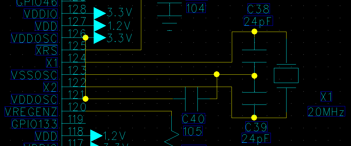

I make a test board using 28377D.
But, there is a error when using external X-tal.
I used CX5032GB20000(20Mhz) as X-tal and designed the board referring to the spruhm8a (tms320f28377D Manual).
As the clock source is crystal, I selected the option 'b)' in page 108 of the manual.
I also did not connect Vssosc pin to the board ground, because when using external crystal the pin has to be disconnected to the board ground as written in the sprs880a (tms320f28377d datasheet).
However, the error is occured during connecting the board.
The error code is this.
Error connecting to the target:
(Error -233 @ 0x0)
The JTAG IR and DR scan-paths cannot circulate bits, they may be broken.
An attempt to scan the JTAG scan-path has failed.
The target's JTAG scan-path appears to be broken
with a stuck-at-ones or stuck-at-zero fault.
(Emulation package 5.1.641.0)
But interesting thing is this. When the Vssocs pin is connected to the board ground(what the datasheet do not recommend), the board works well.
My question is,
1) what is problem about the error? is there any non-provided connecting method which I did not know?
2) Is it okay using the Vsscos pin to connect with the board ground what the datasheet says "do not connect"
Sungho
