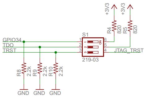

I am working with a custom hardware which has a design very similar to the f28335 experimenters kit (TMDSDOCK28335). I have tested the design and everything works as expected.
Presently, I am trying to write an application code which I want to execute on power-up. I have programmed my code to boot up from Flash and what I am seeing is that, I need to use CCS to overcome the break-point at main() before the application code can execute. This is not desirable since I want the application code to execute automatically without having to connect to CCS each and every time.
On inspection, my vague understanding tells me that the TRST_bar signal needs to be pulled low for this to happen. Is this correct? Unfortunately, my hardware design has the TRST_bar signal connected to logic high and I have no way of doing this. Is there a software way of pulling low this signal?
