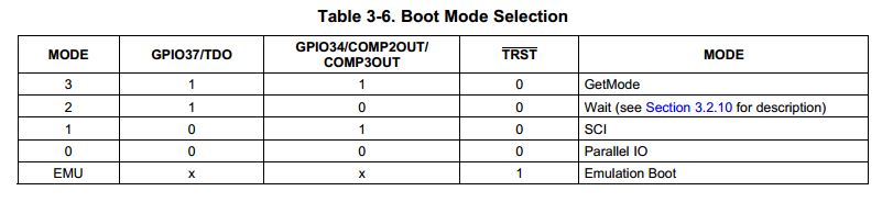

.text: { *(.text) } >> FLASHC| FLASHD
i am using F28035 based Piccolo F2803x ControlCard & Docking Station USB-EMU. After writing the code, it works perfect. But after power reset, it does not work. It indicates that the program is not running from flash. Please help me to solve this.
