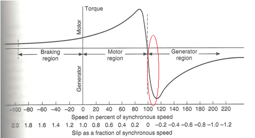

We are testing a high current ACIM for use as a generator.
This uses custom hardware controlled by a 28069 microcontroller.
It uses an encoder for position calculation and the slip magnetic angle from the SLIP_getMagneticAngle (slipHandle) call for controller input.
The software is based on Motorware 14 InstaSpin  lab 5a
An example of using and ACIM as a generator is referenced in:
https://e2e.ti.com/support/microcontrollers/c2000/f/171/t/337405
This includes the following diagram.
Our current motor to generator transition control is via changes in:
- direct current reference value (Id) and
- direct/quadrature current (Idq)
The questions that we have are:
- What other settings affect power generation and negative torque control?
- What controls can be used to tune this for more efficiency?
- What is the best way to control varying torque over time, both positive and negative?
- In the diagram the braking region takes place with positive torque.  Is there a braking region with negative torque separate from the generator region?
I appreciate your assistance with these questions.

    Id and Iq are the main variables.  Both affect the amount of torque, and consequently the amount of power generation.  But they affect torque and power in different ways.  Id sets the rotor flux in the machine, and the time constant for this is typically very long (on the order of several hundred milliseconds, depending on your motor).  So this variable is usually set to reflect long-term operating characteristics of the machine.  Iq sets the quadrature stator current, which is also directly proportional to torque.  But the time constant for the q axis is extremely fast.  The transfer function from Vq to Iq has a time constant which is approximated by adding the stator leakage inductance to the rotor leakage inductance, and then dividing by the stator resistance.  So Iq is the variable you should adjust for quick transient response of your system.

    If your synchronous speed is negative instead of positive, then the braking region will exist in quadrant 4, where the torque is indeed negative.  But just a note about the braking region:  It is not a very effective or efficient way to stop an AC induction machine due to the extremely high slip that is required.  Perhaps this is not a concern to you.  But if you do need to operate in braking mode, I would consider DC injection.  Technically, since DC injection is at zero Hz, it is still braking since it does not result in regenerated energy.  The energy ends up being dissipated in the motor resistances and the power switches.  But if you are equipped to handle the regenerated energy, the fastest and most efficient way to slow down the motor is to just set your Iq value to the maximum negative limit allowed until the speed slows down to the desired value.  In a field-oriented system, this is automatically accomplished by simply commanding a lower speed, and letting the output clamps of your speed PI controller limit the commanded Iq current to a safe negative value.

    - Also, in reference to the diagram in the previous posting above, will setting the Iq value to the maximum negative limit maintain slip in the 0 – 1 range for positive (motoring) torque and slip < 1 for negative (generating) torque? The desired operation is to use generating mode and not the braking mode to apply negative torque.

    - Does this mean that the Id values should always be positive or is this referring to an absolute value and Id could be set to a positive magnetizing current value for positive torque and to a negative magnetiZing current for negative torque (generation mode).
    - What are the consequences of using an Id value greater than the magnetizing current and why is this not usually done?

  • "- Does this mean that the Id values should always be positive or is this referring to an absolute value and Id could be set to a positive magnetizing current value for positive torque and to a negative magnetiZing current for negative torque (generation mode)."
    Always positive. negative Id would be field weakening in a PM machine. In an induction machine it would mean you aren't inducing any field and the motor would not produce torque to rotate the rotor.
    "- What are the consequences of using an Id value greater than the magnetizing current and why is this not usually done? "
    This is the field boosting region. It is done if you want the motor to produce higher than rated torque for a short period of time. For example this is done in compressor systems that may be initially under a very heavy load. This allows you to properly size the motor to the smallest power possible and not oversize for the very small amount of time you may need large torque at start-up.
