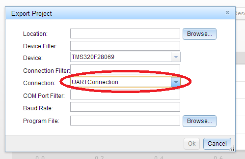

    Thanks for your rapid response. As you advise I have revisited the “Exporting Application for use with GUI Composer Runtime” section of the “ProgramModelUart GuiComposer” wiki.
    In the first paragraph of this section, it says “The main difference is that export dialog needs to have UART connection selected during export”. Just below this text there is a picture of the Export dialog which shows 8 fields. The second field “Connection:” shows “UARTConnection” has been selected. I assume this is what is being referred to in the text.
    My problem is that I don’t know how to get this “Export” dialog to appear which has these 8 fields present. When I click on the “Export Project” button within the GUIComposer Projects Palette, I get an “Export” dialog with only 6 fields visible. The fields are Location:, Device Filter:, Device:, Connection Filter:, Connection:, and Program File:. In the Device: field I select TMS320F28069.When I then try to select an option in the Connection: field the “UARTConnection” option is not present. There are only a range of XDS type options in the drop-down menu.
    The fact that I don’t get the 8 field “Export” dialog (shown in the wiki) when I click on the “Export Project” button within the GUIComposer Projects Palette is what is throwing me.
    So I don’t know how to ensure that the “UART connection is selected during export”.
    Dave

  • This is a known bug, but the fix has not yet been released.  Luckily, the fix is easy to apply.
    Back up the existing file, then replace ccsv6/ccs_base/common/targetdb/drivers/gti_uart_driver.xml with the attached file.

    Darian
  • Hi Darian,
    Thank you for getting involved. I followed your instruction. I replaced the existing gti_uart_driver.xml with the new version but it hasn't made any difference. I still get the 6-field version of the dialogue when I click on the "Export" button within the GUIC Projects Palette.
    As before the project and gui seem to work ok from within ccs.
    Dave
  • Dave,
    What version of CCS/GUI Composer are you using? I am using CCS6.1 and after dropping in the xml file suggested by Darian, I was able to see the UART connection for this device.

  • Hi Dave,
    I mean the connection in the GUI Composer export dialog. And yes, the ccxml file editor should have the UART connection for the "Alternative Communication" in the ccxml file editor.
    I have attached two images showing the UART connection on my CCS6.1 install after dropping in the xml file.
    CCXML file editor:
    This is what the Export Project:
    Patrick
  • Hi Patrick,
    On following your instructions I can now get a GUIC Export dialogue which has 8 fields. Below is my understanding what goes into these fields:-
    Location: Set to where the export zip file is to be stored. So presumably it can be anywhere.
    Device Filter: can be left blank
    Device: TMS320F28069
    Connection Filter: can be left blank
    Connection: UARTConnection

  • Hi Patrick,
    I followed your instructions to export the GUIC project with the Export dialogue settings as below
    Location: Uart_demo_app.zip
    Baud Rate: 9600
    Program File: C28_UART_monitor.out
    (the other 3 filter fields were left blank)
