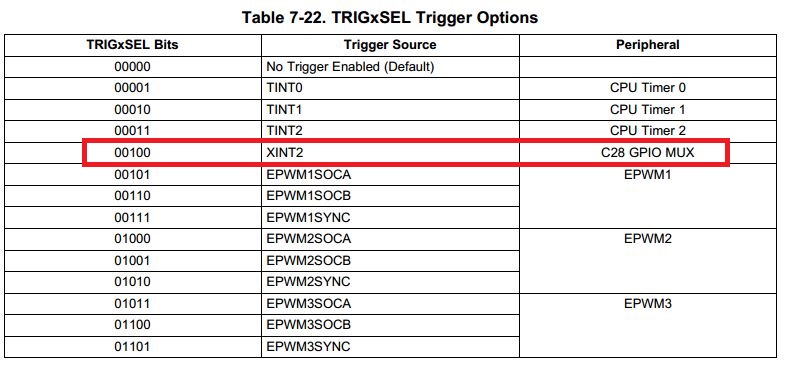

I have to start conversion of ADC by GPIO.
So I have used ADCEXTTRIG but no result.
So Can You help me how to do ADC SOC from GPIO.

You can use ADCEXTTRIG or this purpose.
Please refer to -
www.ti.com/.../spruh22g.pdf
Table 11-2. TRIGxSEL Trigger Options
Option "00100" ADCEXTTRIG
Also GPIO pin selection for the same can be done from GPTRIP2SEL reg.
GPTRIP2 (TZ2n, ADCEXTTRIG) Input Select: Register (GPIO0 - GPIO63)
