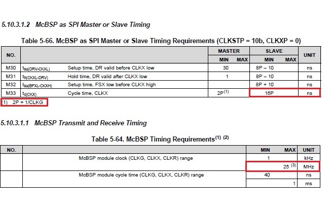

I want to know "cycle time" of McBSP Slave mode.
Is tc(CKX)[min] correct in the following calcultion?
tc(CKX) = 16P
= 8 * 1/CLKG
= 8 * 1/25MHz
= 320nsec
I'm cofused regarding following discription.
    tc(CKX) = 16P
    = 8 * 1/CLKG
    = 8 * 1/25MHz
    = 320nsec
    Yes, this is correct (assuming you have configured McBSP to generate 25MHz CLKG). If you configure the McBSP to generate CLKG with higher frq then this value will change.
    In McBSP, SPI clock frq in slave mode need to be 1/8 of CLKG and CLKG should be 1/2 of LSPCLK. Which basically means max frq for SPI CLK in slave mode cannot be more than 1/16 of LSPCLK. Same thing when translated into time, minimum cycle time for SPI CLK in slave mode is 16 * LSPCLK period.
    Can I generate the CLKG higher than 25MHz ?

  • Hi Mino,
    Yes, you should be able to generate CLKG with higher frq in SLAVE mode if using the LSPCLK as source for CLKG (as given in note in datasheet).
    I understand the confusion because of the table you are referring. I think it's applicable for some specific mode. I'll check on this and see if we could add some note in document for clarification.
