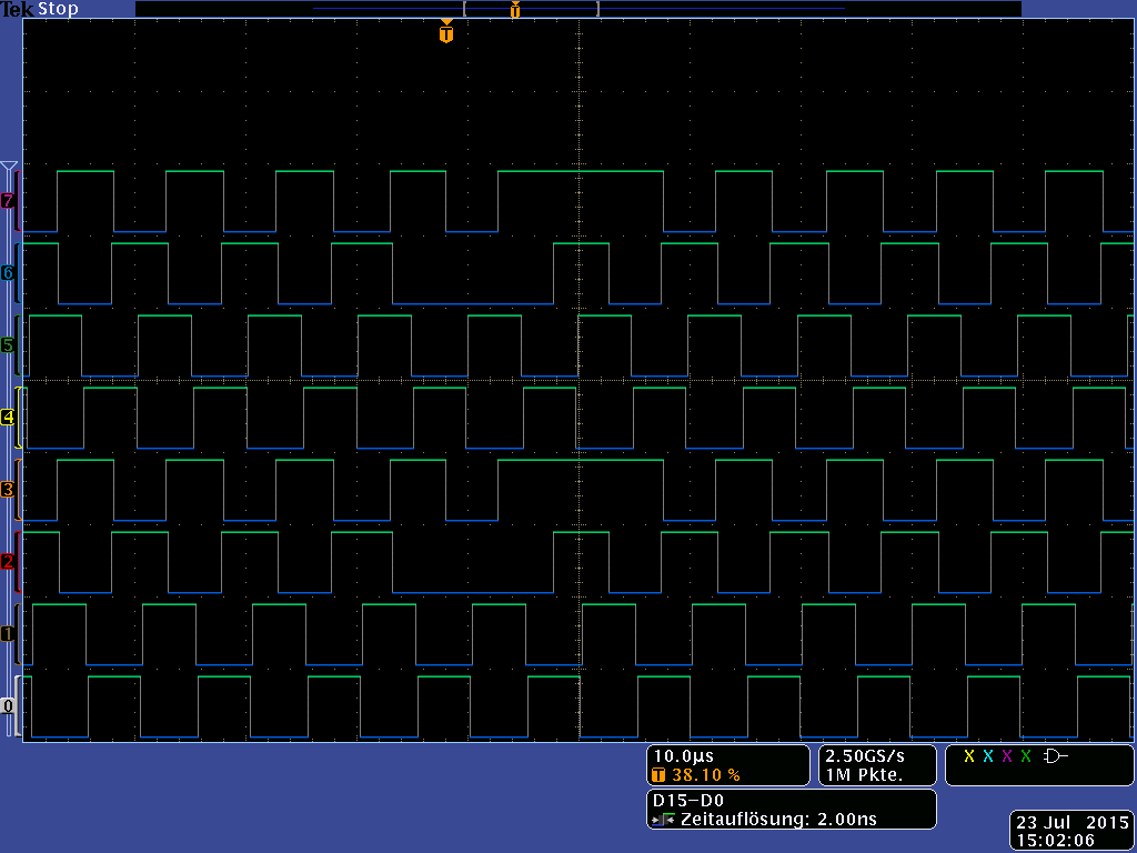

Now begins the problem. When I'm raising my phase shift and come to the two critical points of TBPHS = 216 or 243 the PWM jumps a compare event and the signal is completely screwed up. You can see it here in this picture:
This PWM signal will result in a shoot-through and kill the MOSFETs.
I tried to force a compare event when this happens and it kind of works. I force both signals to high (the PWM will be inverted externally), so a shoot-through will not happen. But that is not good enough. The signal still is completely screwed up and practically unusable.
So...is there an elegant way to solve this problem? Only using up- or down-count method doesn't work either. The cause of the problem are the 2 cycles delay between master and slave PWM modules (at least I think), so it won't really go away with another count method.

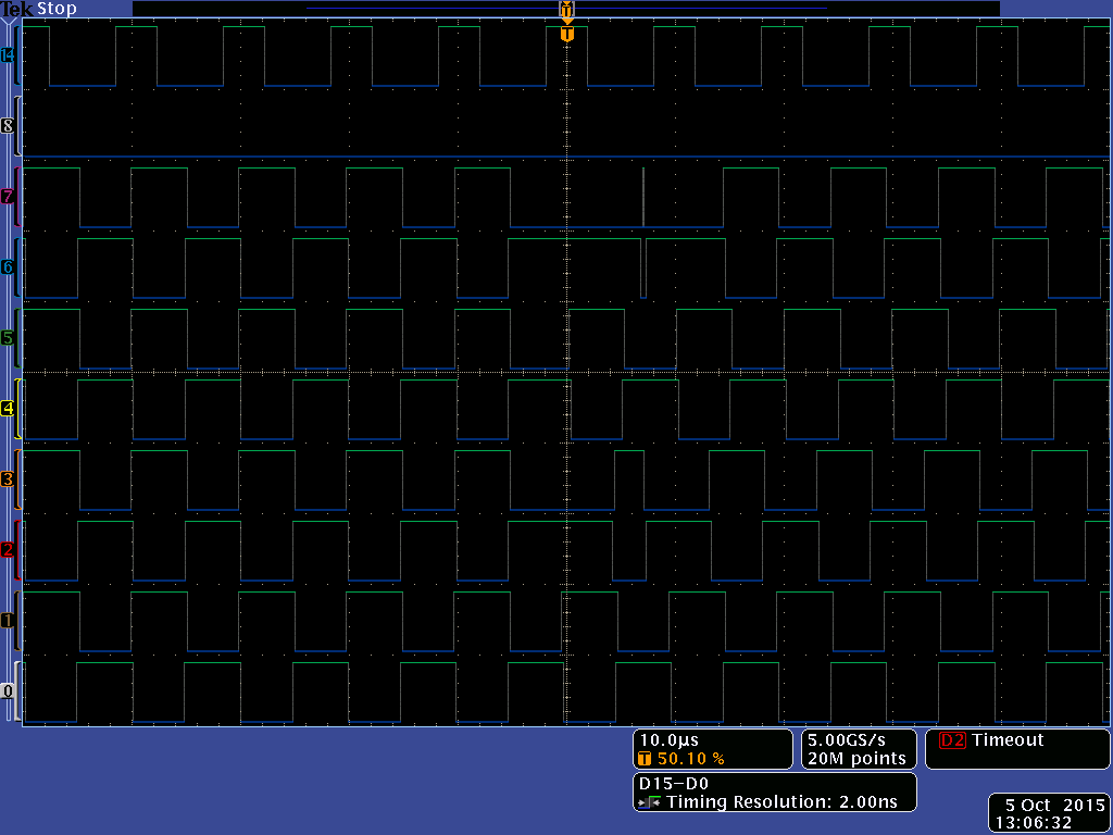

  • Hi Hrishi,
    I know that this is normal. It also probably won't affect the operation. But I still have some strange things happening. You can see it here in the picture:
    Channel 6 and 7. I'm not exactly sure what is happening. This is a jump from a phase shift of 3 (PSDIR = 1) to 448 (PSDIR = 0). I'm doing the check you have suggested and I also check the PSDIR and change the limits accordingly.
