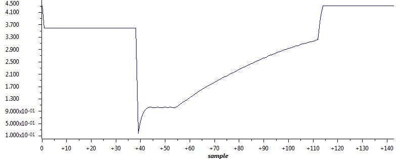

I am trying to perform identification of an ACIM motor with lab02b. My motorware version is 14.
It performs identification with DC bus voltage 320V. There is no problem. But when I increase the DC bus voltage to 400V after EST_State_RatedFlux estimator state becomes EST_State_Error. At EST_State_RatedFlux state it seems that motor frequency is restricted to 1 Hz instead of 5 Hz.

But I think instaspin assumes that the motor is Y connected, but my connection is delta. Is there any thing I need to change in the code for a delta connected motor?For an example do I need to change the values in user.h?
What can be the reason for the estimator SW to enter into error state?
