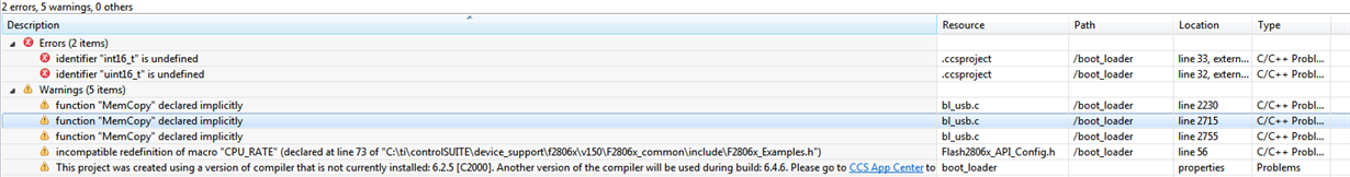

2) I can't compile the boot_loader project due to
- Error : "identifier int16_t is undefined
- Warnings : function MemCopy declared implicitly
I checked the includes and linker option and it seems normal.
