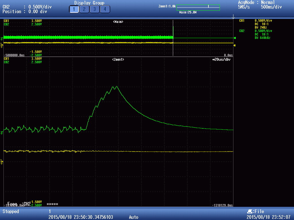

I am experiencing a perplexing problem with the TMS320F28335. I am using it to control an LLC resonant converter, where my sensors are monitoring DC values. I am running the system in open loop, so said sensors are only monitoring and not controlling the system. At seemingly random, the DSP will calculate a suddenly large value for a single computation cycle while no such fluctuation occurs at the corresponding input pin.
Measurement setup:
Isolated scope-corder with 100MS/s isolated channels
Measuring voltage at the ADC input pin with CH1
Using an ePWM port at 200kHz and measured through 10KHz low-pass hardware filter to create real time digital-to-analog (D2A) output - CH2
Software protection shuts the system down if the ADC result passes an internal threshold
Observing the first scope capture below, you can see that when the spike is observed on CH2 (D2A), CH1 (ADC pin) shows unusual fluctuation at all. CH2's output becomes notably less noisy after the the spike because hardware protection is triggered at that moment, indicating the value from the ADC result  buffer is being represented by the D2A output (as opposed to an issue with ePWM module/code). I would have suspected the acquisition window was not wide enough, but I would expect that to generate a low value rather than an extremely large one, since the sensing capacitor would not be insufficiently charged in that case. Indeed, increasing the ADC acquisition window did not have any noticeable effect. I have monitored the execution time of the ADC as well, and the sequence is completed well before the next iteration.
To make matters more interesting, there is another F28335 on the control board controlling a previous stage of the system, which is NOT experiencing this issue, that has identical hardware configuration, System clock configuration, High-speed clock configuration, and ADC configuration (aside from different different number of pins and the SOC is generated from the timer0 ISR rather than the ePWM module). There is also a parallel project in our lab with a near identical control board that is experiencing this issue on BOTH DSPs on three separate boards. We are mistakenly using a 1.8V core voltage while running at 150MHz rather than the proper 1.9V, but many previous projects in our lab have done so without experiencing a similar issue. Furthermore, both projects are using DSPs with different batch numbers.
I have been on the phone with a TI representative who attempted to find a related forum in addition to my own searching, but with no luck. Any assistance would be immensely appreciated!!!
If possible, I would also very much appreciate a phone conversation with your engineers or opening a private email thread with them for additional debugging of this problem.

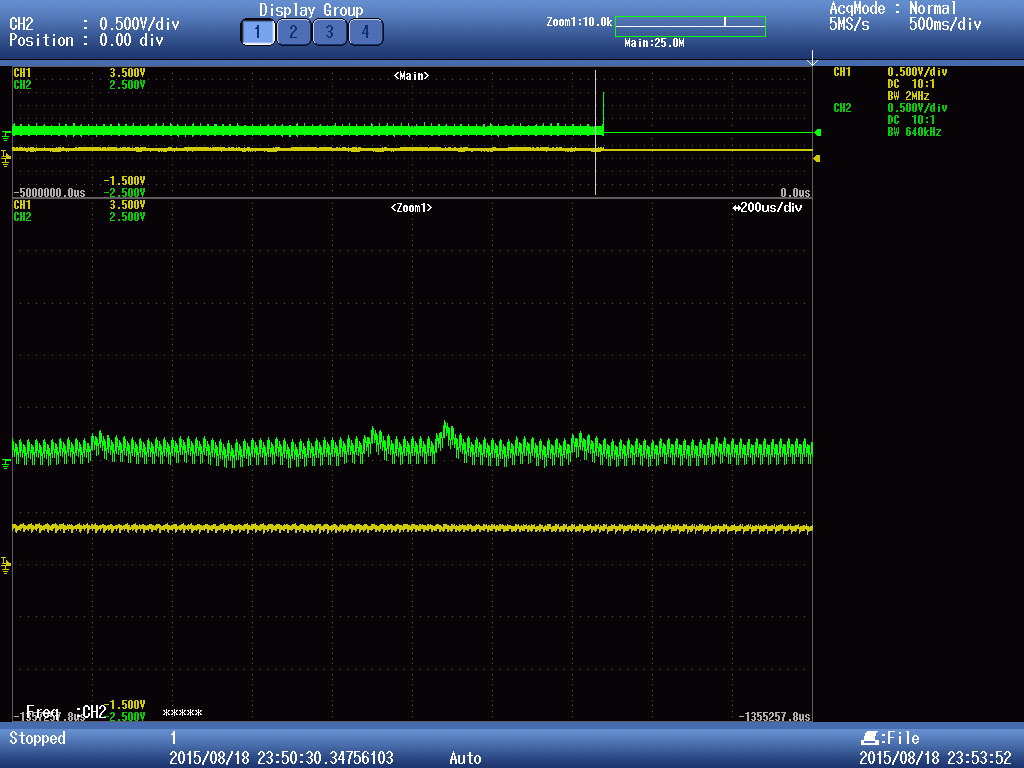

Scope Captures:
The errors are not always large, and, on a smaller scale, clusters of the errors appear to be periodic, but at a much lower frequency than any switching in my system (see 2 captures below: 1st close-up, 2nd frequency):

  • Hi Mike,
    Thanks for the thorough explanation of the problem, this really helps us rule out many common issues and more quickly directs us to a solution.
    From the information provided, nothing stands out as a root cause, of course we are always cautious when the device is used outside DS parameters (i.e. 1.8V@150MHz). In this case I agree it is doubtful to be the cause, but if it is possible to increase the core voltage or decrease the SYSCLK on one failing board it would be good to rule out.
    Additionally can you please confirm that no ADC input pin exceeds VDDA+0.3V even if not the pin being actively sampled? This can cause a leakage path in the channel select mux which affects the converting channel.
    Does the application use EMIF or could there be any other event which might cause several GPIOs to toggle periodically?
    I am circulating your post through some other experts to generate some more ideas as well.

    I try a lot of methods to avoid the spike
     _ Changing the frequency of ADCCLK as well as S/H clock pulse lower or higher
     _ Disconnecting or grounding the remain ADC input channels which I do not use.
     _ Implementing ADC Calibration according to Application Report "TMS320280x and TMS3202801x ADC Calibration" and applying this file
    .www-s.ti.com/.../spraad8.zip.
     _ Trying with different ADC channels,  but the spike/noise also appears.
    Here is some pictures I capture.
    In picture, bottom figure is ADC signal at input of ADCINx of DSP TMS320x28335 and top picture is ADC signal display by DAC. All signals are displayed on Oscilloscope. Beside that I also display signal by graph function on CCS and I also see appear ripple
    Fig.1
    Fig.2
    Fig.3
    Fig4.
    Fig.5
    Figure.1 to Figure.4 (ADCINA0->ADCINA3) ripple is low, But figure 5 has high ripple. And the remain ADC channel also have high ripple except ADCINA0->ADCINA3(low ripple)
    I really appreciate your help now, because I need to solve the problem of ADC for my project.

  • Hi Duc-Dung Le,
    Is there any difference in the signal conditioning circuits or signal source for channels 0-3 vs. the rest of the channels? Are these inputs buffered? You said that you tried different channels...does the issue always go away when you use channels 0-3 with whatever source is giving bad results on channel 4+?
    You may want to set a breakpoint after the ADC initializations run and then use the expressions window to examine the ADC registers to ensure your configurations are getting written as intended.
    It looks like you are zeroing out the bottom two bits of the ADC reading. Is this because the DAC is 10-bits?
