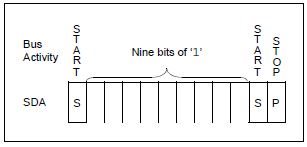

Hello all,
My EEPROM chip requires the DSP to send the following signal to reset it:
Does anyone know how to do that on F28069. Using I2C free data mode might be a good solution. But how to deal with the ACK bit and how to deal with transmitting 9 bits of "1".
Fei
  • Fei,
    I think it would be easiest to toggle the I2C pins manually in GPIO mode. Configure the pins as open-drain outputs in the GPIO control registers, then set the mux bits for those pins to zero. This will let you toggle the pins.
