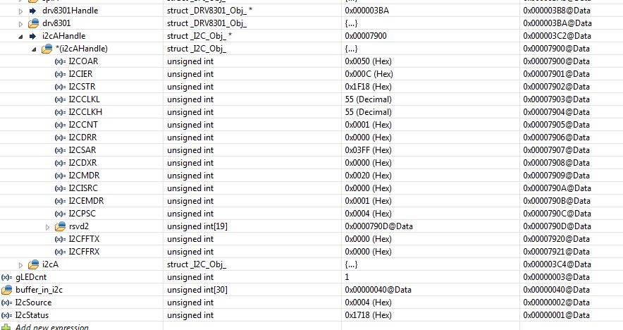

Hi all, I'm trying to get i2c work as a slave (on GPIO 32 and 33) in lab_5b but it doesn't work.
I have a LaunchXL F28027F and a BoostXL-DRV8301
I use a atmel avr as a master, the i2c clock is at 100khz.Both sda and scl havea 4.7kohms pull up.
I use the i2c.c/h from maria
e2e.ti.com/.../1203642
When the MCU starts, there some signals on scl and sda pin (I don't know why)
and then the SDA and SCL line go low (If i am right they should be high)

When i start the MCU, The I2C registers are I think correct (set as setup in HAL_setupI2cA(handle);
The odd thing is I got some signals in i2c pin even if nothing is plugged on i2c pins.
The gLEDcnt variable is 1, so it enter in the i2cisr and then the i2c pins are both low.
so no communication is possible.
I tried to put the HAL_enableI2cInt(halHandle) in the forever lopp after the while(!(gMotorVars.Flag_enableSys));
It is the same behavior expt that the gLEDcnt is still a t 0 but i2c pins are low.
The signals in i2c pinsat startup are there even if i didn't do a HAL_setupI2c.
What's wrong ? where is the mistake ?
