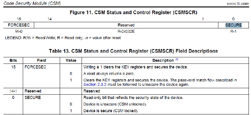

how to confirm my mcu locked?
Other Parts Discussed in Thread: TMS320F28033, UNIFLASH
I am using TMS320F28033 MCU and CCS 6.0(I also tried to use ccs 5.5 and had already installed controlSUITE ) to debug my code using XDS100v3 Emulator(00IC-xds100v3).
C28xx: Error connecting to the target: (Error -1015 @ 0x0) Device is not responding to the request.  Device may be locked, or the emulator connection may be unreliable. Unlock the device if possible (e.g. use wait in reset mode, and power-cycle the board). If error persists, confirm configuration and/or try more reliable JTAG settings (e.g. lower TCLK). (Emulation package 5.1.232.0)
