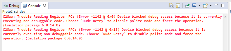

Everything was going great with the development until this morning.  I received the following error as soon as I clicked the green Run arrow in the debugger:
C28xx: Trouble Reading Register PC: (Error -1142 @ 0x0) Device blocked debug access because it is currently executing non-debuggable code. Choose 'Rude Retry' to disable polite mode and force the operation. (Emulation package 6.0.14.0)

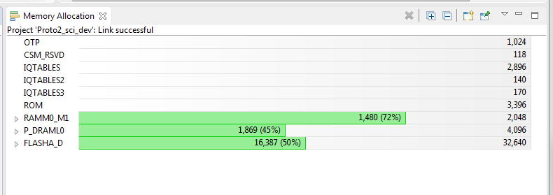

Any ideas what I did to create this?  BTW - I changed my F28027F.cmd file to fix the FLASHA_D starting address bug.  Changed it from 0x3F4000 to 0x3F0000.
Here are the error message, Memory Allocation and the run error windows:
