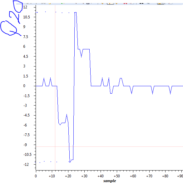

I am using TMDSRSLVR kit to measure angle to use with TMDSHVMTRPFCKIT. But there ware some issues with resolver kit. I have listed them below.
1) I can see only five discrete angle positions from rslvrOut.angleRaw per one resolver cycle. Those are -12, 5, 0, 5, 12,  in iq20 format. And I can not see any other numbers between them. I have attached the graph of rslvrOut.angleRaw for a one resolver cycle.  What should be the problem. Can't I get more angle values smoothly from the TMDSRSLVR kit.

  • F28069 has floating point unit, while F28027 has fixed point. You need to use the floating point .lib file?
    rgds,
    ramesh
  • Thank you. solved the problem by using floating point unit. I have another question.
