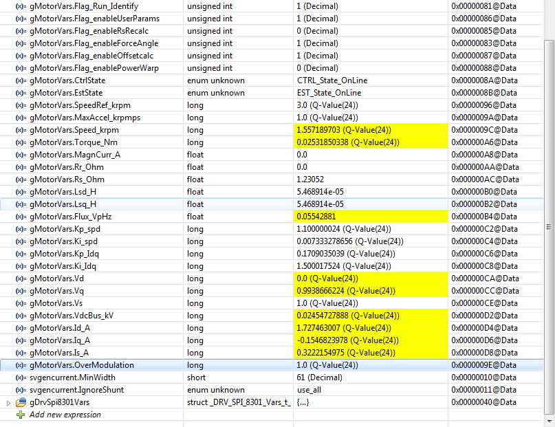

    3. to do some debug use proj_lab10 please.  Command 3 KRPM and note the speed and the value of gMotorVars.Vs  .

    the poles are right, i tested it. only with setting of 4 pole pairs the speed between 0~1500 rpm are set and get correctly. with other pole pairs(2 , 8) the speed that set and get respectively half or double of real one(checked with tachometer).
    1. with setting USER_MOTOR_FLUX_EST_FREQ_Hz  to 100, the speed reach to 1500 rpm during identification. by increasing this param(ex. 200), when the motor want to go upper than 1700 rpm during identification, the rotor locks, the spinnig stop but the sound of increasing speed will continue.
    3. i have ran the  proj_lab10a and command 3 KRPM to motor , the result shown in pic below:
    using over-modulation in proj_lab10a result these:
  • motor manufacturers have over designed certain types of motors to give very large R / L. This is for voltage stability with open loop style techniques. With InstaSPIN-FOC you could design the motors better (would reduce the torque ripple). We know this isn't really the case though, people use what motors are available.
  • I can tell there is something wrong because your Id_A value isn't close to zero. All your current is in the Id vector and very little in the torque producing Iq vector. This suggests the estimator is off. Could be from poor current/voltage feedback or from improper motor parameters.

    in the over modulation lab you can't use a value of 2.0.
    if using MotorWare v14 you must limit this to 1.333
    If using MotorWare v15 the limit is 0.666
  • i'v checked the overmodulation( MotorWare v14), the values below the 1.33 have no effect on speed.
