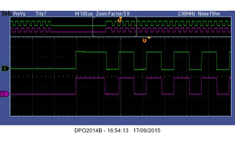

Hi ,
I am trying to run complimentary pair PWM's for my dc motor. I turn on and turn off the PWM's in intervals .
When I turn ON my PWM's , the first cycle always seems to have a longer duty cycle compared to the rest of the PWM cycles .
Could you please tell me why this happens.
Kind Regards
Anish
  • Hi Anish,
    Try setting the correct CMPA value during peripheral configuration. Btw the above waves are not complimentary. Check the ePWM userguide or TRM for your device for proper complimentary ePWMs.
    Gautam
  • Hi Gautam ,
    Oh sorry , forgot to mention . These are the low phases(CMPB) of PWM1 and PWM2. I wanted to show that it was consistent. I have given the correct CMPA for the high phases and it works fine. But for my low phases is always wrong . Would there be some register that I have to reset after I turn my PWMs off ?
  • Can you share the ePWM configuration?

    #include "defines.h"

  • Hi Anish,
    I believe the waveform is for the PWMB output. Correct?
    What is the initial value of CMPB? Can you try a non-zero value?
    -Bharathi.
  • Hi Bharathi ,
    Yes it is for PWMB output .
    The initial value is zero . I did try giving 650 and  1250  , but the motor draws more current and doesnt turn .
