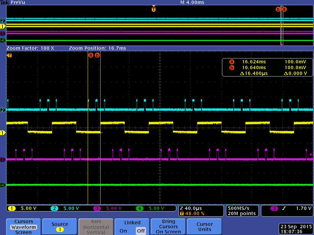

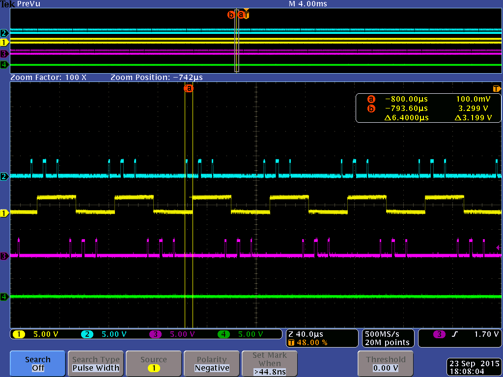

We are using F2812 eva to generate PWM  1 & 2 and evb to generate PWM 12.
Independently, the PWM 1 & 2 and PWM12 can be generated with the correct frequency. So no issue there.
however, there is a drift between PWM12 and PWM 1 & 2.
We don't mind if there is a fixed offset, as long as it is fixed, but in our case, the offset seems not be fixed at all.
See picture below.  Can you please advise on how to keep the Timer1 and Timer4 in a fixed offset?
Yellow line is the PWM 12.  Blue / Purple is the PWM 1 & 2
Thank you so much for your help.

  • Henry,
    Providing the timers are clocked from the same source there should be no drift.  The answer lies somewhere in the way the EVs have been configured.  Can you say a little more about how you are using the EVs and comparators please?
    Also, how is timer 4 involved?  The PWM12 timebase comes from GP Timer 3.
    Richard
  • Hi Richard,
    Thanks for getting back to us.
    On the configuration, PWM1 and PWM2 are configured to be triggered in compared mode running by T1 counter.

    I get the PWM12 setup, but there must be something more going on with PWM1/2. The initialisation code alone won't produce the patterns in the scope traces. The code comments imply you are enabling and disabling timer 1 somehow. Can you elaborate please?
    Thanks.
    Richard
  • Hi Richard,
    Ah, i forgot to mention that we have the ISR set to keep changing the PWM 1 & 2 period and duty cycle because we are driving the sinusoidal signal output. Here is the ISR for it:

  • Henry,
    So, timer 1 UF interrupt modulates its own frequency. It looks like when the index counter is 0, 1, 3, or 4, the T1 period is 266 HSPCLK cycles and when the index is 2 or 5, the T1 period is 268 HSPCLK cycles. Timer 4 period is fixed (at 1600 cycles) so you would expect to see the PWM1 & PWM2 waveforms drift with respect to it. Since timer 1 is spending more time in the shorter period I think it must be drifting to the left.
    To verify this, please check what happens if you don't change T1PR in the interrupt code. Are the waveforms then fixed in phase?
    Richard
  • Hi Richard,
    yes, we modulate the PWM period during index counter 2 & 5. But this modulation is needed to keep the total period of 6 PWM 1 & 2 to be 1600 counts of HPSCLK exactly match with the period of PWM 12 which is also 1600 counts of HPSCLK.
    Basically, the PWM 12 is our sync signal which we hope to keep in a "fixed" phase with the PWM 1 & 2.
    So, i can't see how it could match if we do not change the period for index 2 & 5.
    Henry
  • Hi Henry,
    Yes, you're right.  Unfortunately it can't match.
    The ratio of T1 period to T4 period is either a little above or a little below 6, but switching between them this way won't work because the difference between each ratio and 6 is not a rational number, so I don't think spending a fixed amount of time in each period is going to maintain the phase.
    Can you live with T4 at 1602 and a fixed T1 period of 267?
    Richard

    i played with the event manager some more to understand it and it turned out that the drifting is caused by a misunderstanding or not reading the spec carefully.  The number of count per each of the 1/6 th PWM is ok.
    In the up counting mode, the period is actually PRD + 1 while in the up / count, the period is PRD / 2.
    so, total 6 PWM periods is 1600 which is what we desired to have and our sync signal period should be 1599 instead of 1600.  put this in and it works beautifully.
    so, i would like to post it here so that other folks can pay attention to.
