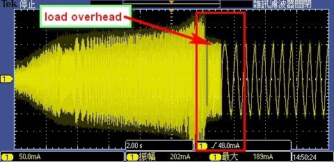

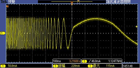

    I have measured some current wave as below.
  • Hi Sir,
    I have done the motor ID many times. the motor parameter is almaost the same.

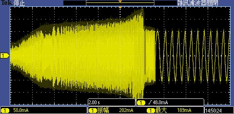

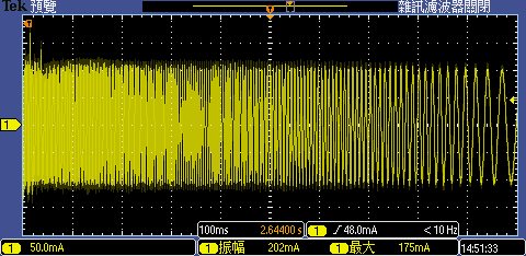

    I have measured load overhead  current wave as below.
    extend load overhead current wave

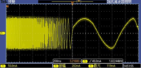

    I have been adjust "user.h  USER_MOTOR_MAX_CURRENT " different volume. When the load is over controller can support max power, The speed & torque are like above picture.
