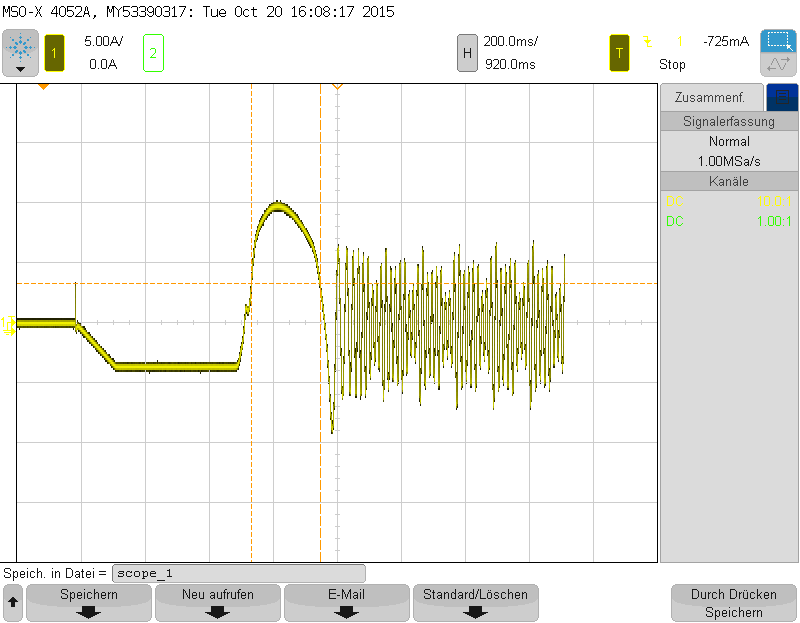

I'm using a TMS320F28062 on our own PCB.
The Compiler is C2000_6.2.6 under linux.
The software didn't use an OS.
The motor has to drive a pump for medical use.
For testing I drive the motor to a (valid) random speed and stop it for one second and repeat that cycle many times.
For motor startup, forced angle is activated, RS recalibration is enabled, but no RS OnLineRecalibration. The motor parameters are well known.
Mostly the motor startup behaviour is ok. That means, it takes about 100 ms for the RS recalibration before the motor starts.
But sometimes the motor didn't start after RS recalibration is done and the estimator state changes to "online". The motor moves only a little bit and starts turning 2 seconds after the estimator has changed to online state.
Is there a mechanism that the RS online recalibration flag is set to true automatically by the estimator ?
For better explanation see the following graph
Debug1 is the commanded speed (It's equal and drawn below the speed reference in the MotorVars structure)
Debug2 is the speed Reference
Debug3 is the estimator speed
Debug4 is the estimator state (multiplied by 1000)
You see, that normally the Motor starts spinning when the estimator state changes from 3 (RS recalibration) to 13 (online). But in the error case the motor didn't start at this time but there is a little movement. 2 s later the motor starts turning.
What could be wrong ?

    what is your acceleration command?
  • Sorry Chris for the late answer. I was ill the last few days.
    my user.h: (how can I attach ?)

  • Thank you Jeff for your tip.
    I measured the motorcurrent in the case of the error.
    Here you can see that the forced angle is disabled too early.
    I increased the zerospeedlimit. At the next scope plot you can see the same error case with increased zerospeedlimit:
    Now i have to tune the zerospeedlimit to the minimum possible value.
    Do you have an idea what minimum value can use ?

  • The cirquit is designed to use the full 3.3 V of the ADV. I set ZEROSPEEDLIMIT to 0.02 and it works fine. Slow speed is strong and constant. Fast speed is constant also.
    But the problem isn't solved completely.
    In some cases forced angle takes too much time. The motor takes more than 1.5 s to start.
    This behaviour isn't 100% reproducable, but very often.
  • Here a scope plot of the motor current.
  • I suggest reading section: 14.4.2 Fastest Motor Startup with Full Load with Motor Alignment Considerations
    From document: SPRUHJ1F
    It gives you some tips to get motor started with load. The difference I notice right away is that you might need to remove the Id reference used for Rs recalibration very quickly when it goes into closed loop. This is described in subsection: 14.4.2.1 Maximize Current Slope
    Also, I noticed that the load is pretty high compared to the current used for Rs recalibration. What this means is that you would need more current for Rs recalibration so that it also aligns the motor to angle of zero. I suggest you increase the value of USER_MOTOR_RES_EST_CURRENT to twice or even three times the value you have, so it actually aligns the motor.
